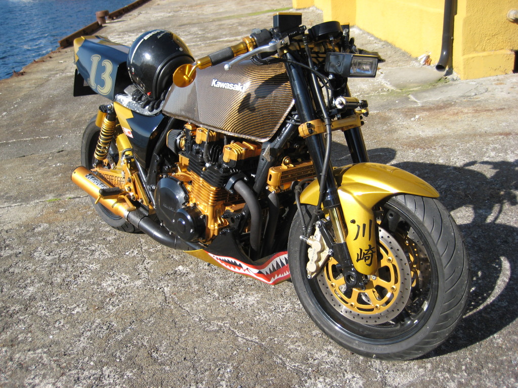

roy used it on this frame.
i have never used it myself.
but everyone says it is top notch.
i am pretty sure all the black on this bike is por-15.
surely we can get someone with first hand experience to chime in
