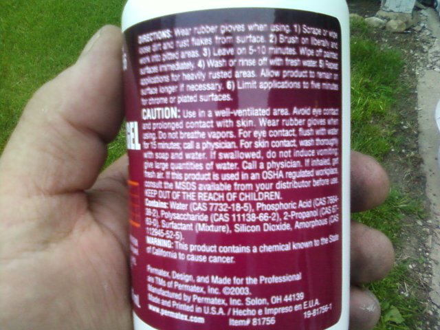

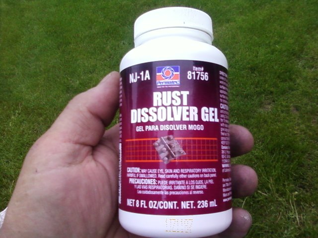

After reading the label on the Evaporust I discovered that it is not a acid base like the stuff I used before and they say to fill the tank up and leave it in up to 12 hours. :whistle:
So I headed out to the Farm and Fleet and bought some more Permatex Rust Dissolver and dumped the whole 8 oz bottle in the tank and left it in for about 30 min. rolling it every so often .
After two treatments the inside of the tank is looking a lot better, I think I'm done.
