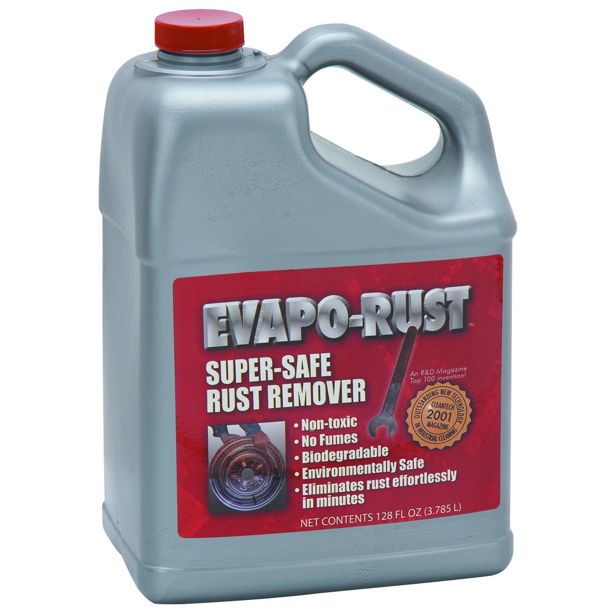

I've heard good reports on Evaporust. Here's another product that's supposed to work.
www.rusteco.com/index.htm
www.rusteco.com/saferway.pdf
The following user(s) said Thank You: Patton, fxdl2051
