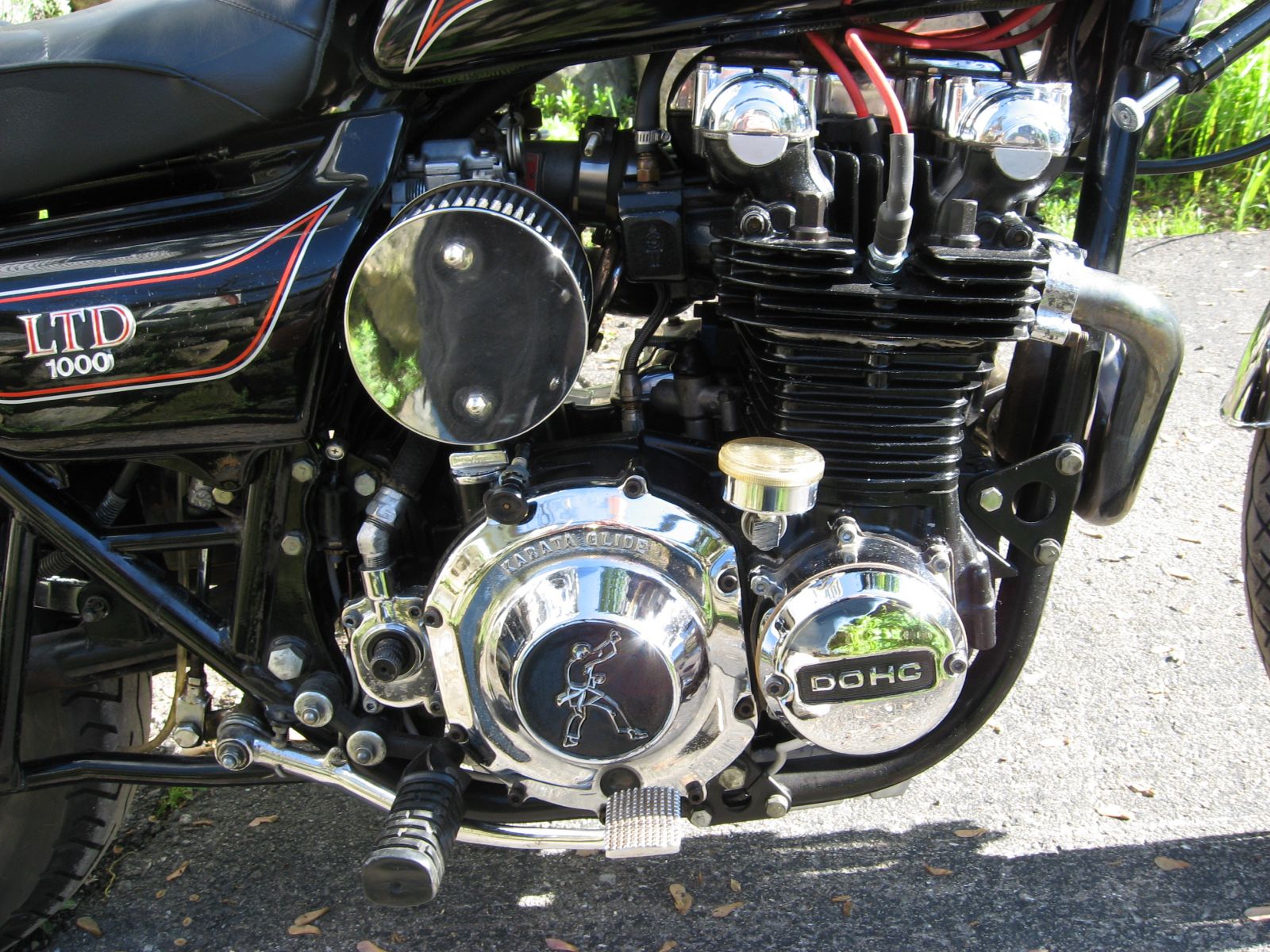

Here's my method. I did the engine cover in the photo real quick like.
Clean & polish the part first. Remove any loose paint if necessary, of course.
Wipe the areas to be painted w denatured alcohol, then use a tack cloth to remove any lint.
Then put a little wheel bearing grease on your finger by just touching the grease
Pat the grease onto the raised areas that you don't want painted. It doesn't take much grease at all.
Spray the part w engine paint.
Let it dry to the touch, then wipe off the raised areas.
On the perimeter of the engine covers I used masking tape - applied quickly.
Then the grease. If you get any overspray, it wipes off the polished part easily.

Using spray paint is easy & looks pretty good.

Wow your motor looks really good Martin! What did you use on your cylinder & head.

05 Nov 2012 13:57I used a spray can of gloss engine paint on my covers . I mask off the outside limits of the area to be painted then after paint I take a clean rag and wipe off the areas on Karata clutch and points cover to be left exposed while paint is still tacky.
