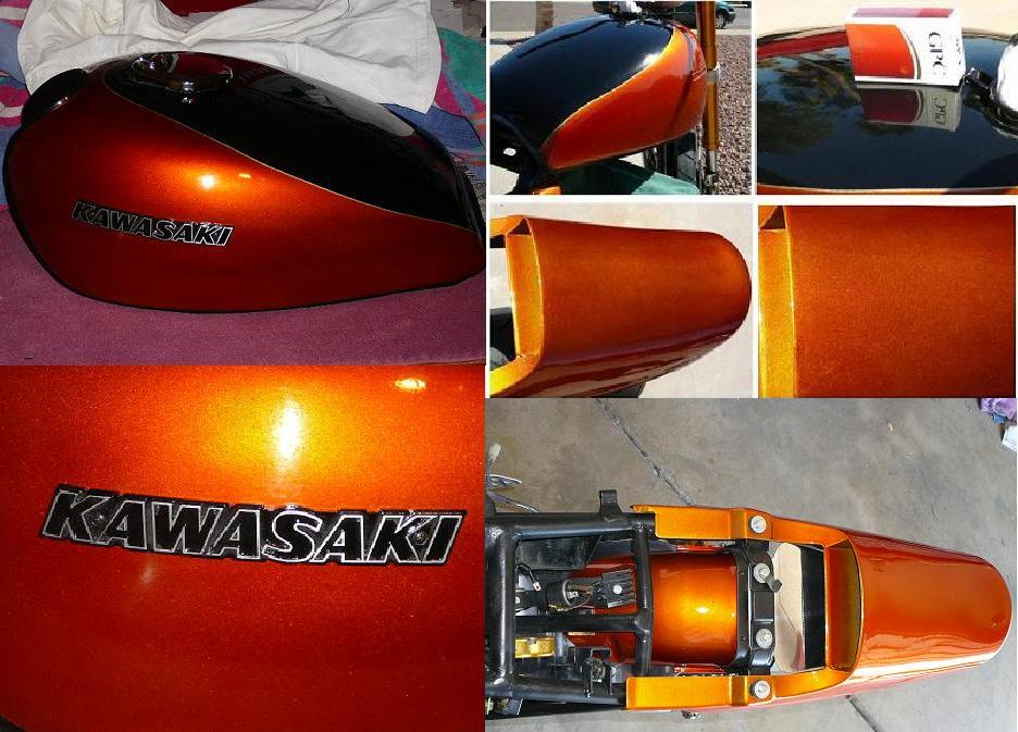

here is a pic of the bike back together. The paint is so uneven on the tank it isn't even funny. It will do as it is way better then the flat black primer that was rubbing everywhere. It really pops orange and metallic in the full sun though.
what ended up making this weird is how nice the tank looks in the garage. It looks exactly like the side panel.
I think i should put on a few more coats to even out the color, thats what I did to the side panels and it fixed them.

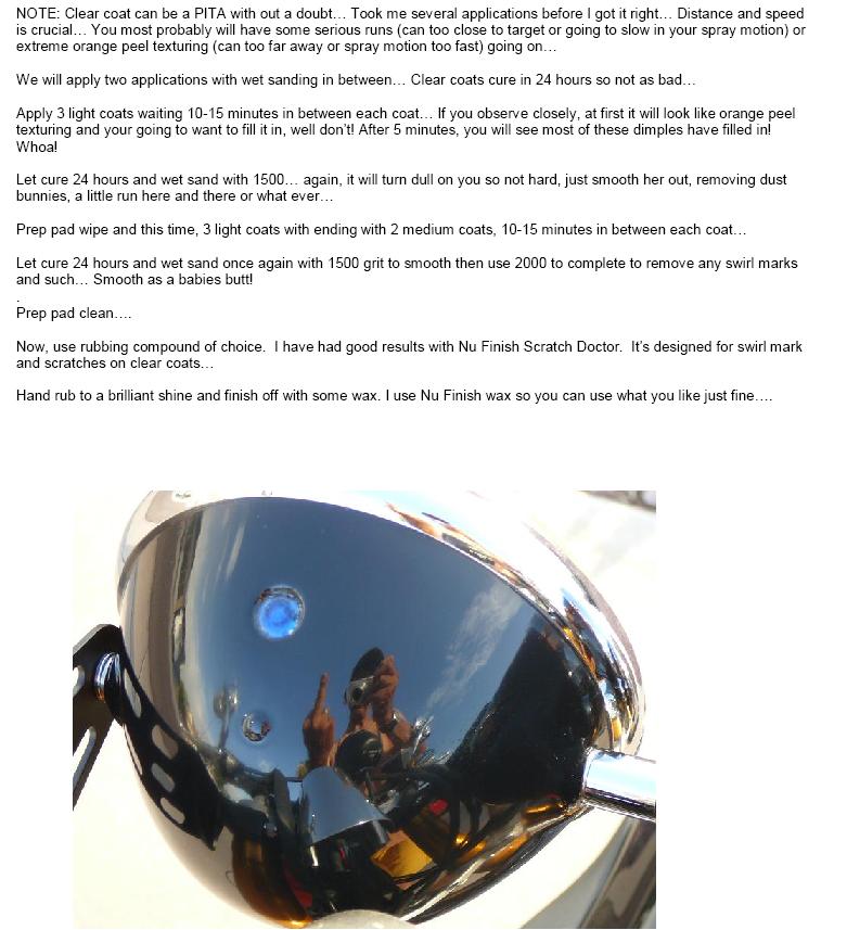

follow link to the process that works just fine...
1000-1500-2000 grit till smooth before clear coat. Clear cures do it again then buff out with rubbing compound/Dr Scratch Nu Finish... Comes out beautimuss.
Can Painting
Can Painting

What Old Man Rock said. That will help you through the process.
I actually had a friend give me a 3000 grit sanding sponge. Was firm and I was able to sand a nice even surface on my tank to prep the clear before polishing it.
As far as the basecoat, follow what Old Man Rock said and it should help you through it.
