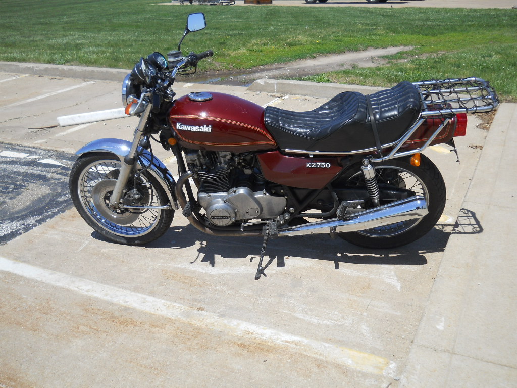

Topper, this is an aftermarket seat on the stock pan that came with the bike when I got it. No markings, no tags.
The seams are starting to rip. If I could find a other (cover or complete seat) I would in a heartbeat, comfy seat.

That does look comfy. But I think I want something a little more subtle. I'm leaning towards getting an ltd cover for a 1980 750 and adding to my foam.
