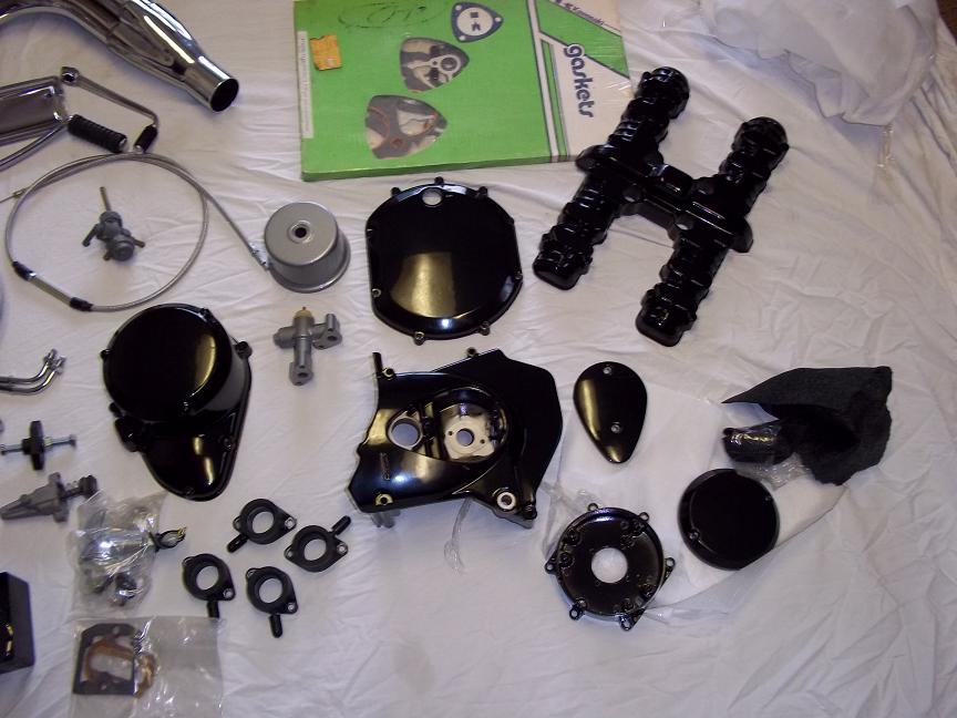

Here is a set of Z1 covers done in black.
I paint my heads, barrels and blocks.
It is ready for an aerosol paint. Paint the block, and powder the covers.
