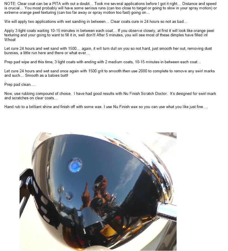

Re: Polishing Clear Coat
15 Jan 2012 12:20

- gaillarry
- Posts: 82
15 Jan 2012 13:46
Thanks for the input, I happen to have some Nu Finish Scratch Remover and lots of 2000 wet/dry sandpaper.
