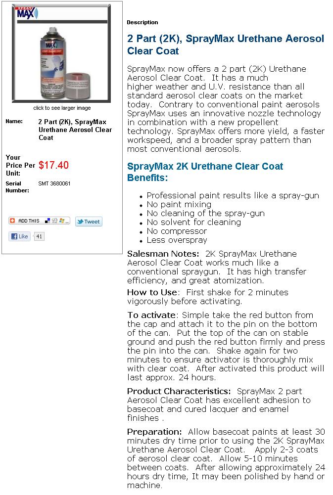

Just Google searched... Application & Data sheet link included... 24 hour cure time....
SprayMax
Definitely let us all know how this works out if you use it, especially on a FUEL test ....
