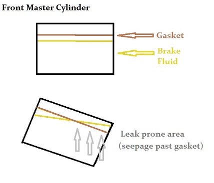

18 Jun 2011 22:46martin_csr wrote: ...As for the mc, yours has an angled mount, so it will sit at an angle on flatter bars. You can use it that way, but a different mc might be better....
Yes.
Angle mounted M/C invites leakage.
