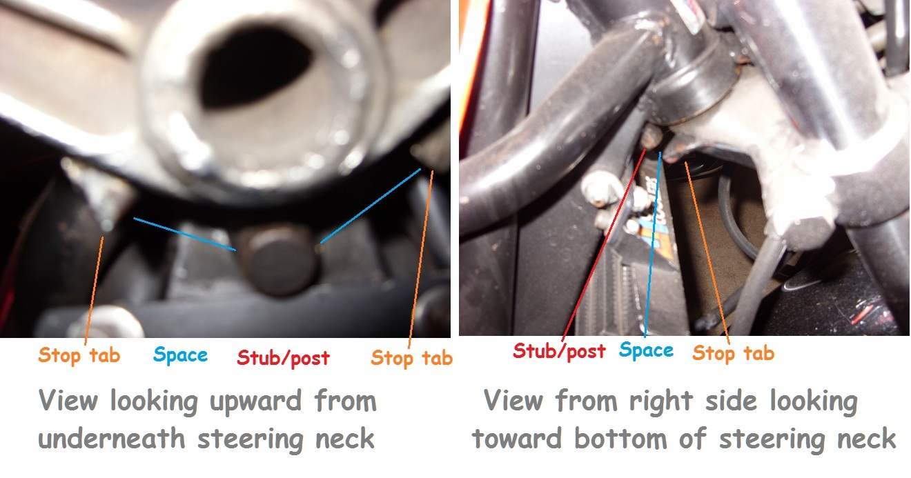

Might be feasible to decrease the lock-to-lock swing distance of forks, and thereby keep the forks from touching the fuel tank at full lock position on either side.
This may sometimes be accomplished by adding material to increase the diameter of the metal stub/post that serves as a stop to limit sideways movement of the fork when the stop tap meets the stub/post.
Examples would include a larger ring (short tube) pressed onto stub/post, or welded, or set screwed, or whatever other means to hold the ring onto the stub/post.
Might even be feasible to press a tightly fitting short length of heavy duty rubber hose (such as automotive fuel line) onto the metal stub/post.
Also possible to weld additional material onto the stop tabs so they make contact with the stop/post sooner.
See image below.
See image below.
