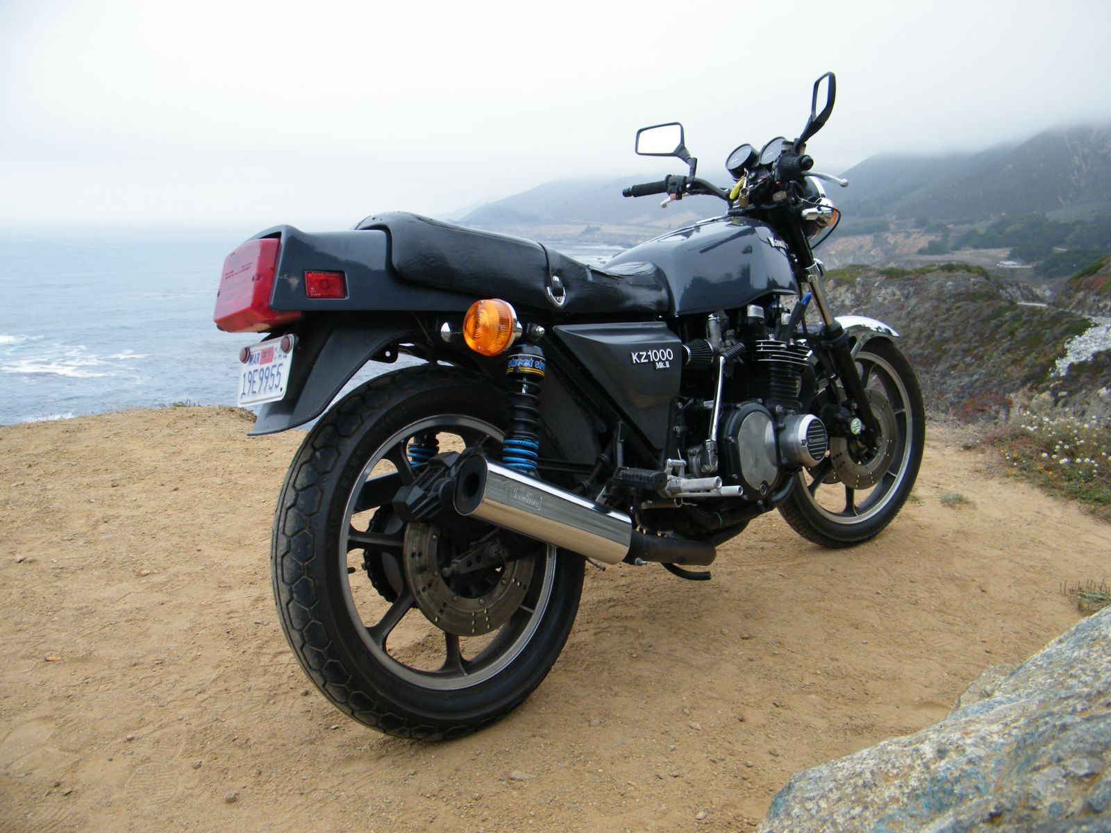

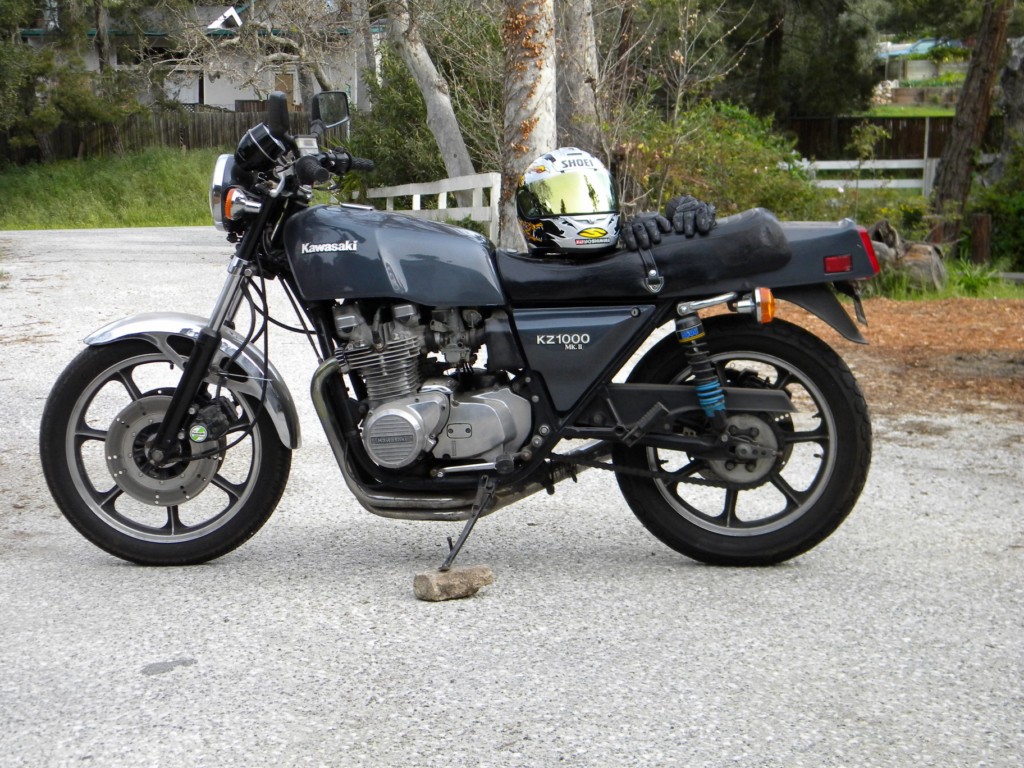

separate subject in a way..."paint letting engine breath /cool itself correctly"...
i did my current project in auto store satin engine paint...and it may be running hotter now :whistle: ...hard to tell as i did not get to ride it before painting but once...
i have heard/read that some motorcycle engine paints are better at letting the motor breath...i do not know if this is true and i only used light coatings and a smooth thin finish....
i may be worrying too much...or misinformed....either way
it had been stripped of it's MKII factory scheme and i re-did it....
i will strip it again when i do the frame next season....
sorry for the hijack sort of...may tie in with others comments to your situation
before
after
