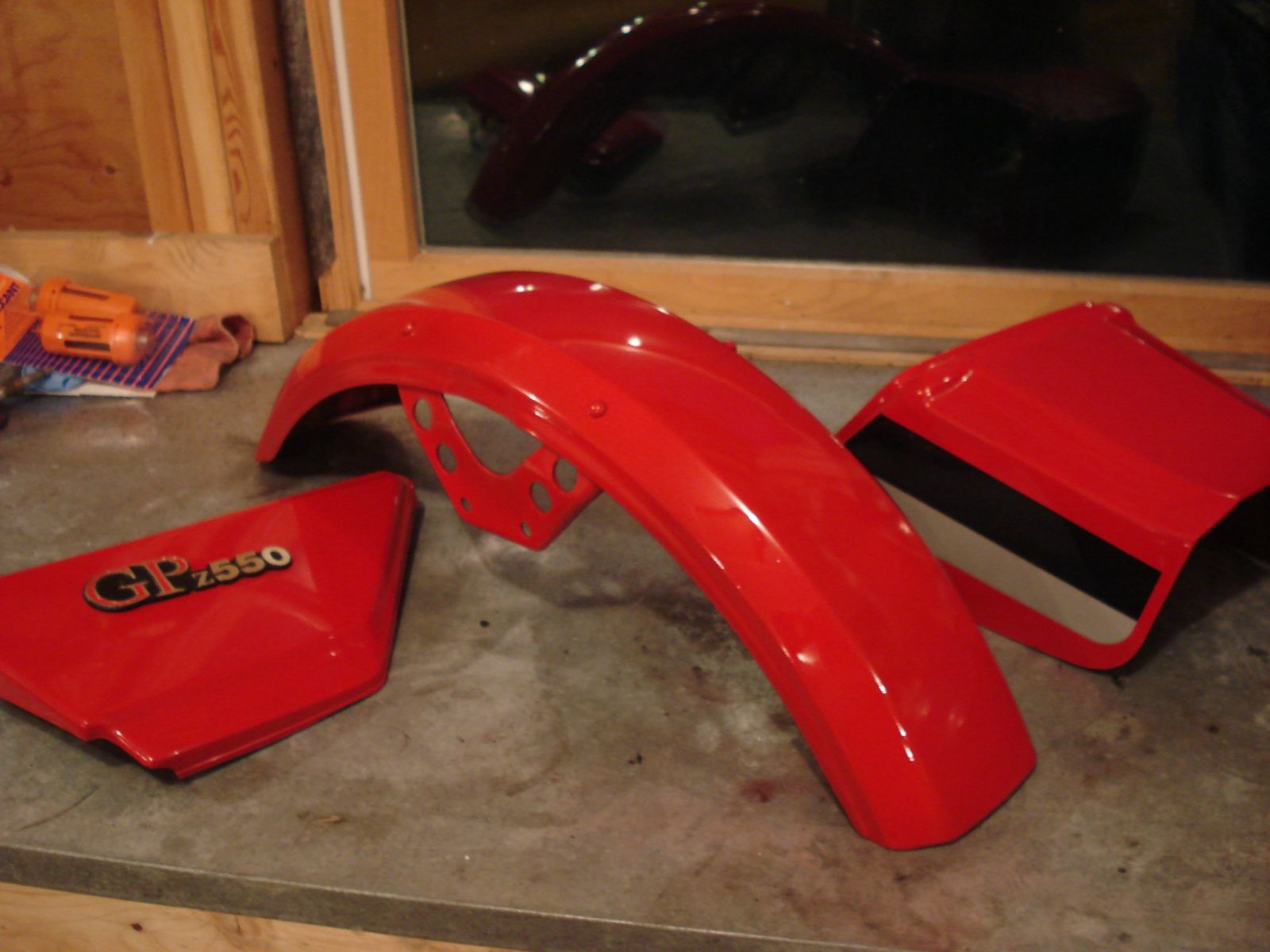

Good call on the color, Mcdroid !
I did the fender, the other parts are OEM paint
On the bike, and in outdoor lighting. The side cover, front fender, and fairing are repainted with Cardinal Red

Yeah!!!! Looks great!

Thanks, first time spraying body parts.
I still have to do the fairing and a pair of side covers, and both of them are going to need some prep first.
It was a bit of an adventure getting the paint:
After getting the color info above I went back to NAPA, and they didnt have a listing (that the guy could find) for Ford/Mercury Cardinal Red. Since the GPz color is very close to my Mom's Miata, that shares the garage with my bikes, I just had him mix up a pint of Miata red, figuring that I'd give that a try. He told me that it would take 30 min. to get it ready for me.....
So instead of sitting around waiting, I went across town to an auto paint specialty store that had the color scanner. I had them scan the sidecover that is in the pic. The color came back as an exact match for a Master Craft boat color. They mixed it up and it was way lighter......So I said "Ford/Mercury Cardinal red is supposed to be close". I bought a pint of single stage and went back to NAPA to get my Miata red. I'll give the Miata paint a try at some point, it's base/clear, but the Cardinal red single stage was a good match for sure
