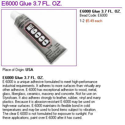

Re: Stripped hole for tank emblem mount
09 Apr 2011 09:56
