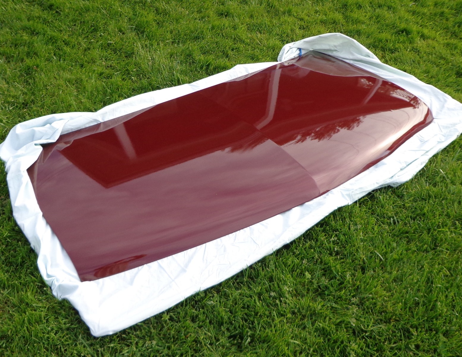

I can do the 1977 colors too. I picked up a N.O.S. blue tank and a good red tail section to do the color matching from. The Blue is a solid red oxide base color, silver mid coat flake, candy blue topcoat. The Red is a solid pale red base color, silver mid coat flake, candy red topcoat.

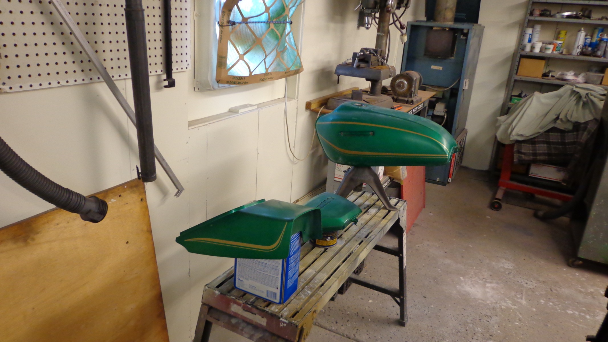

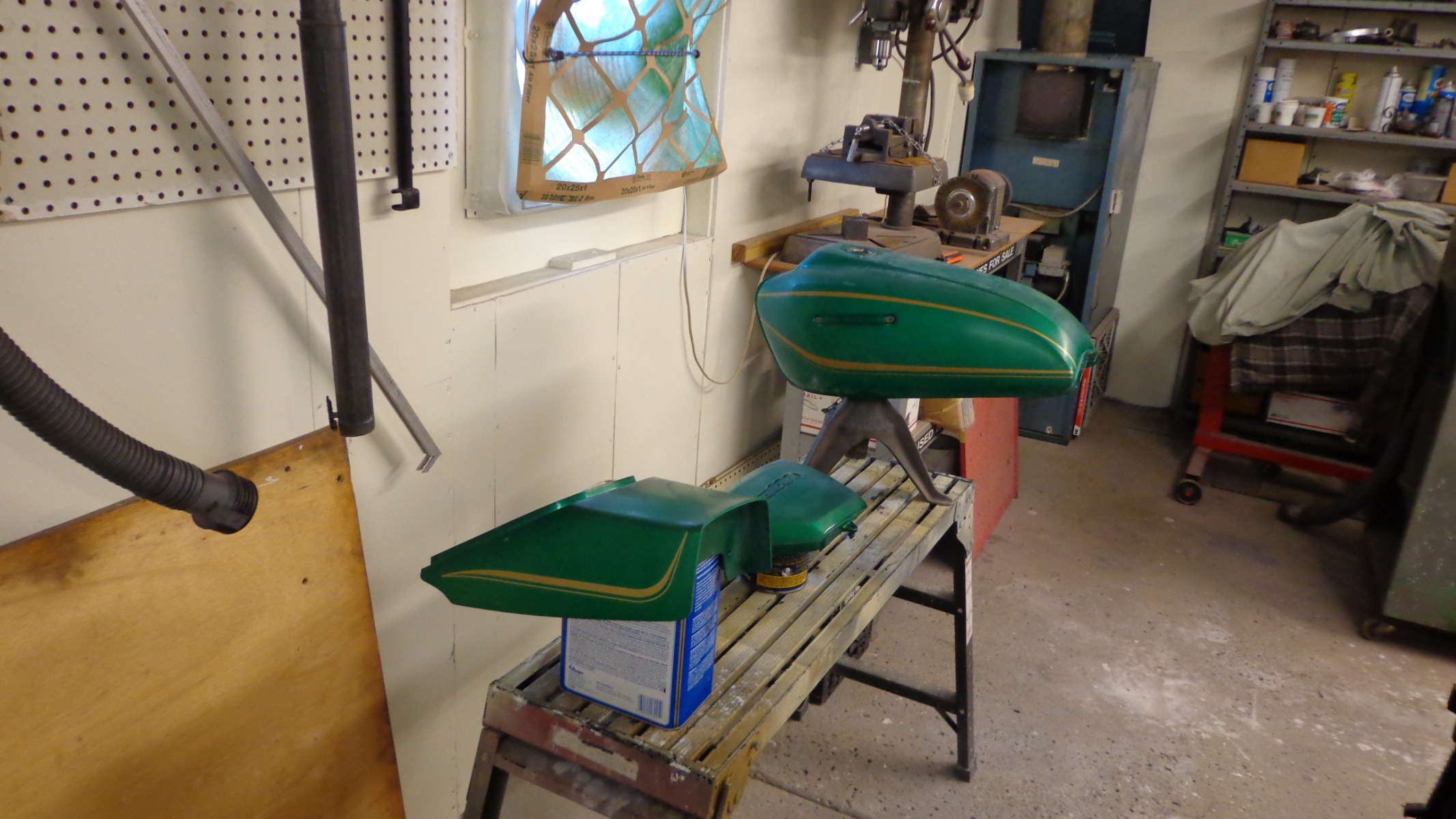

Have a pinstriper guy just hand paint them. He will open his case he brings with him, then whip up a few enamels to get a match, as long as you have something to show him. I did the green 78 400 in background. I took a cover to my paint guy, he whipped some up. And believe it or not. The gold stripes are from a rattle can. Then I just cleared it with urethane. This was just a quick, did not care paint job.
