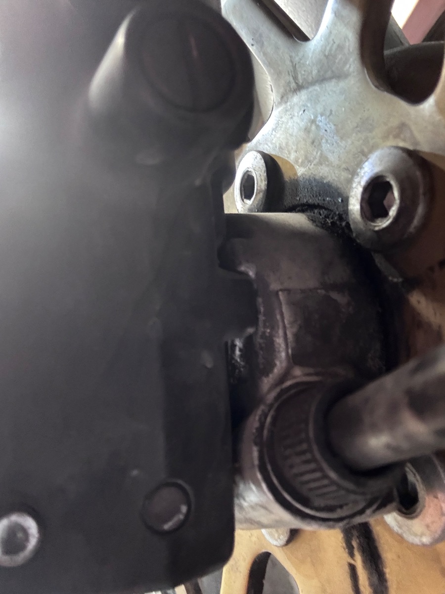

My 78 KZ build is still going, getting down to details. As you may know I am doing all ZRX suspension which brings me to the question. Is this the proper indexing for the speedo gear on a ZRX?

12 Oct 2026 19:06Nope. It needs rotated up until the “tab” on the drive is above the tab on the fork leg.
Here’s a Zrx1200 that I happen to be working on.

After I correctly positioned the speedo gear for the ZRX it got way better. This site has been extremely helpful in my quest. I got info from another member that rectified the problem.
