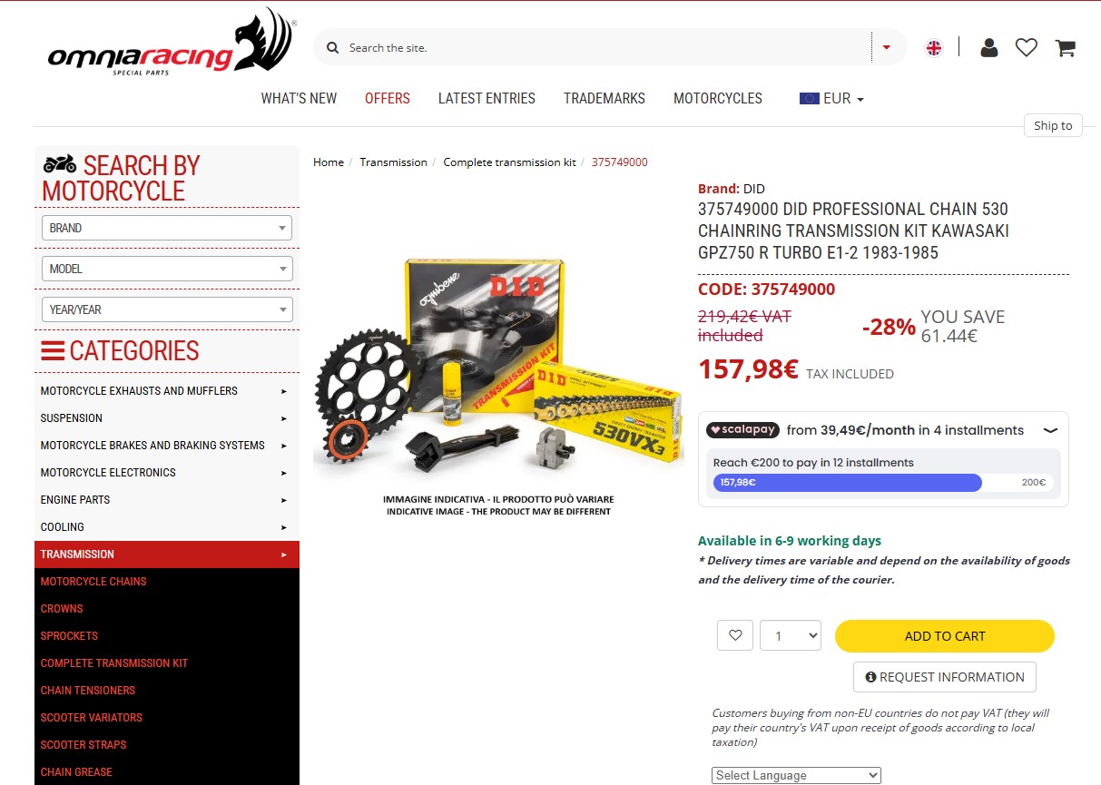

Re: 83 GPZ 750 chain conversion
24 Aug 2026 08:04If your bike is a "uni-trak" this seems to be the only one that might do it (there are a couple of other suppliers for the twin shock R1 GPZ)Could you link these because I can't find anyNot sure where in the world you are ? there are kits listed to convert to 530 but these mainly seem to be from European suppliers so if you are in the US shipping and tariffs will make it expensive
Transmission kit DID Professional chain 530 sprocket Kawasaki
- notgoodwithnames
- Posts: 55
- Thanks: 4
24 Aug 2026 08:59This is for a 750 turbo which does not have an offset sprocketIf your bike is a "uni-trak" this seems to be the only one that might do it (there are a couple of other suppliers for the twin shock R1 GPZ)Could you link these because I can't find anyNot sure where in the world you are ? there are kits listed to convert to 530 but these mainly seem to be from European suppliers so if you are in the US shipping and tariffs will make it expensive
