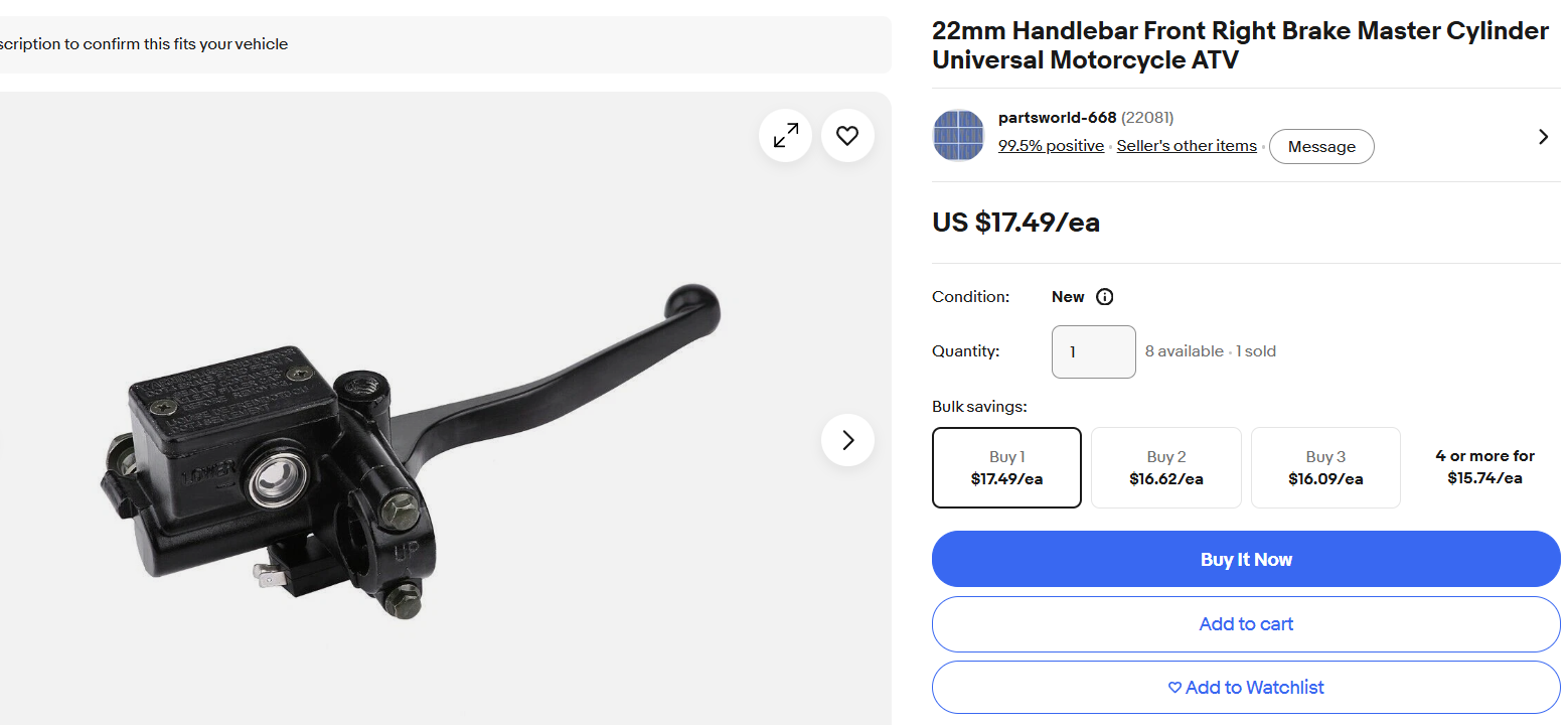

I build my own brake lines using Earl's components. High-quality stuff, and quite easy to build. Been doing this for 40 years now. Regarding the master, I'd just look for a decent replacement with a 14mm piston. There are tons of generic masters in the market, and most are fine. Brake master cylinders are pretty simple, and even the cheap stuff is generally decent.

what handlebars? and does your m/c have an angled mount? also. the 0.9mm difference matters?
