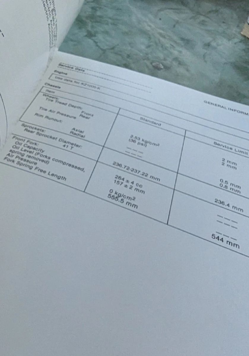

This is so silly but I got very lucky! I was looking on ebay for a service manual for a kzp and found a listing with an opened page of the exact info I needed!!!!! if the image is too blurry, it calls for oil capacity of 264±4cc and an oil level of 157±2mm with the spring removed an the forks fully compressed.

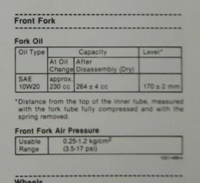

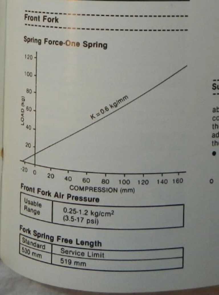

Edit: here's a couple more pictures that I found!!! Im dreaming! Although it looks like the fitted a couple different springs in the kzp forks.You know what ill be doing tomorrow...
