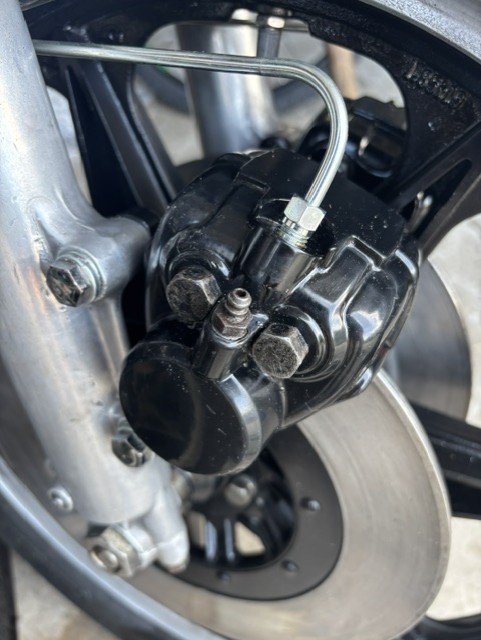

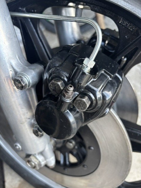

Hi, i have a caliper on my Z1000A1 that has a leaking bleed nipple, the fluid is coming out of the hole down the centre of the nipple, i have tried a new nipple , same issue, so it is not seating in the bottom of the caliper, tried cleaning down in the caliper but i have the same problem, im thinking the caliper is U/S, does anyone have a     caliper for sale in the UK.

You could try carefully cleaning the nipple seat by hand with a drill bit (10mm thread so an 8mm bit would clear) the nipple just needs a clean surface to seal against

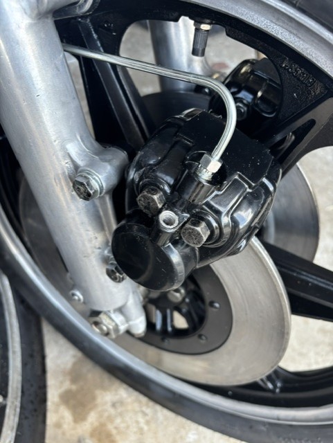

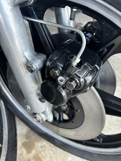

Thanks for the response Wookie58, i have tried cleaning down in the caliper, this is a replacement caliper that i bought and after looking at it again i think the problem is that the bleed nipple screws in so that the nut is flush to the caliper, so possibly been over tightened and therefore damaged the seat area in the caliper, think the solution is another caliper.

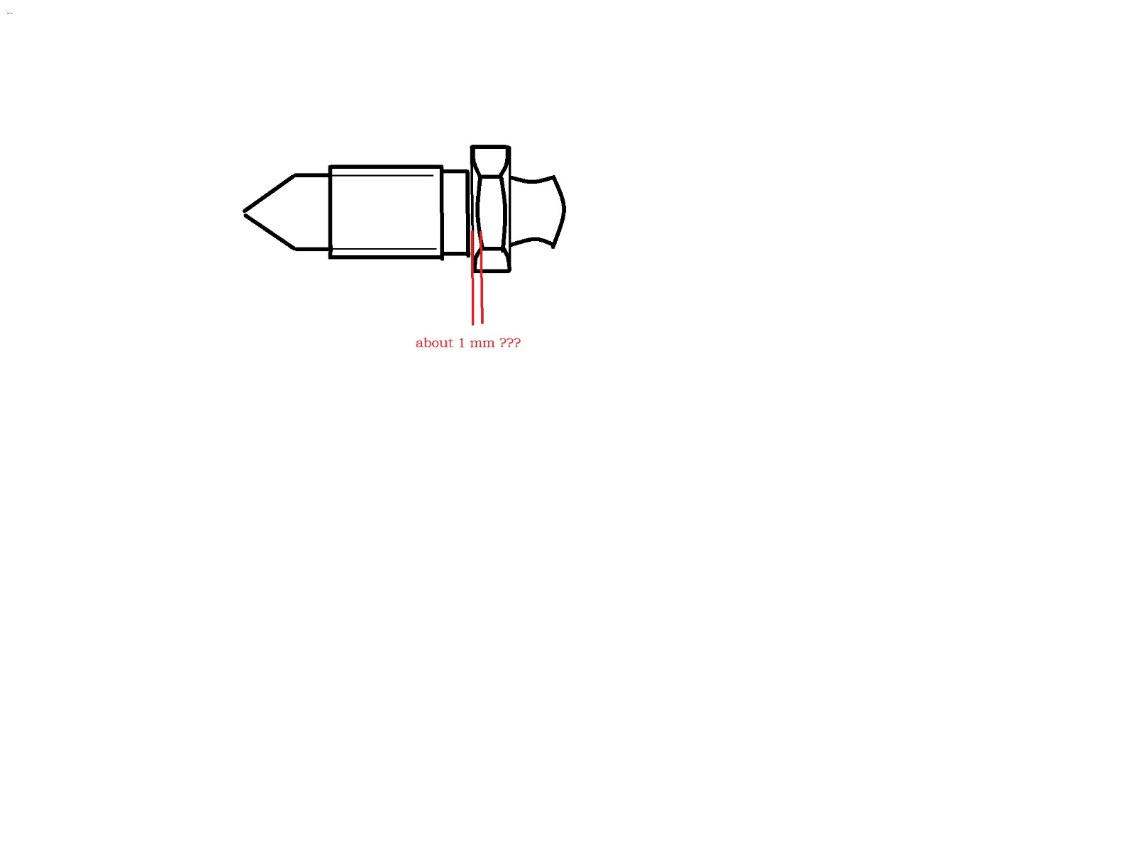

I had already noticed from the photos that the "shoulder" of the hex head appears to be resting directly against the caliper housing. This suggests that someone likely reworked the depth of the bore and the seat at some point and went "too deep" in the process. Possible solutions might be: a) getting a longer bleeder screw; b) using a lathe to machine a relief cut into the bottom edge of the hex head to gain more depth; or c) getting a new brake caliper.

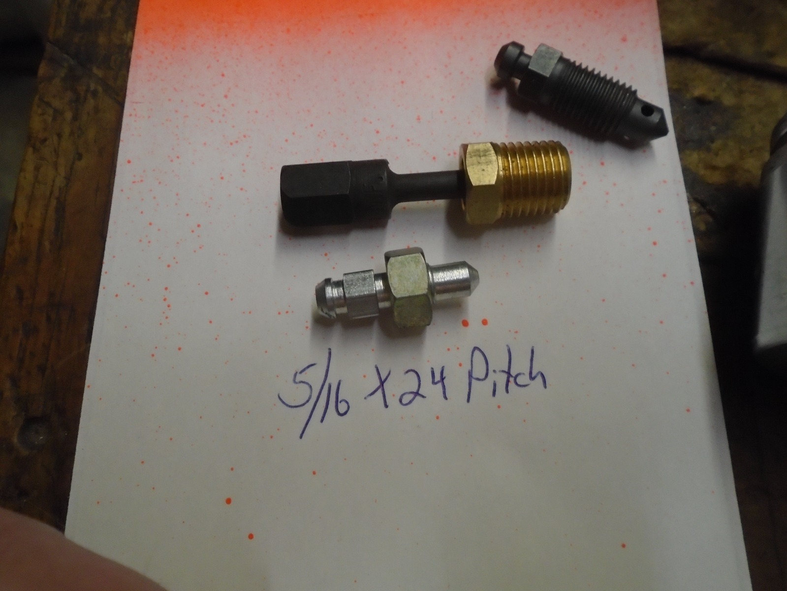

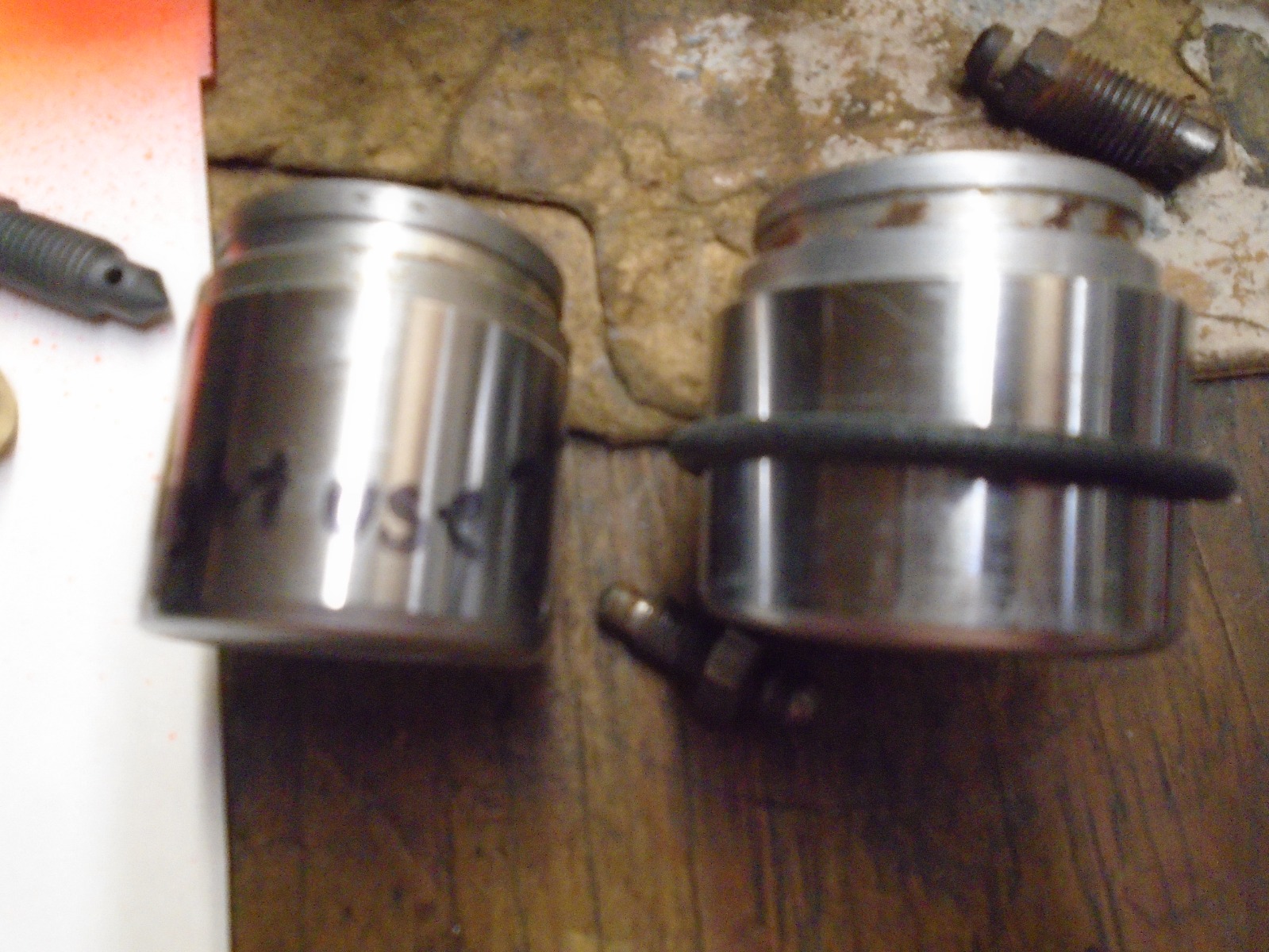

#925496
