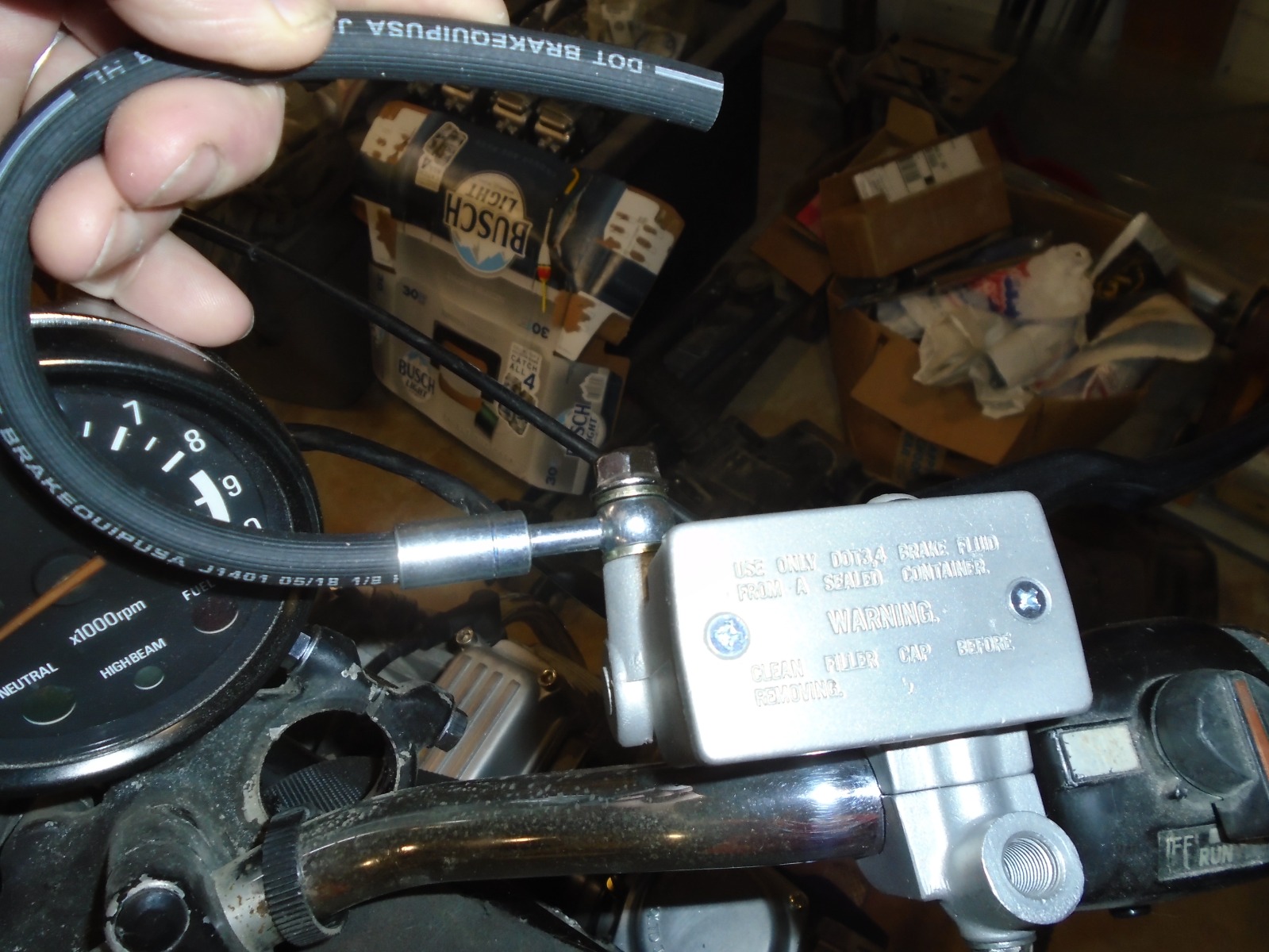

If You are in the US, try BrakeQuip. I buy their 1/8" brake line in bulk and their 10mm banjo fittings. I cut/fit and index banjo ends here and reinstall OEM springs if any and take it to town where they have the machine to do the crimping. The brake line itself is "pretty" similar to OEM, ribbing is slightly courser then the finer ribbing on originals but if using a spring over you'll never see it anyway. I use Tomkins Industries out of Olathe, Kansas but You could call BrakeQuip directly and they can tell you where a local distributor would be/not be in your area.

Glad to expand Conrad. I do a multitude of various brands/models. Also having to shorten master to splitter length of hose for low rise handlebars. I don't know what Z1E is asking for brake lines? Just a reference though each Brakequip banjo fitting used was 12USD per fitting. So 4 would be required for single disc, 6 for duel. Then add for the 1/8" line, 10bucks a linear foot. Now you would have to find an authorized Brakequip dealer to crimp the ends on. You can see costs escalating. I do it for convenience and ability to customize, I'm not really concerned about the additional costs.
