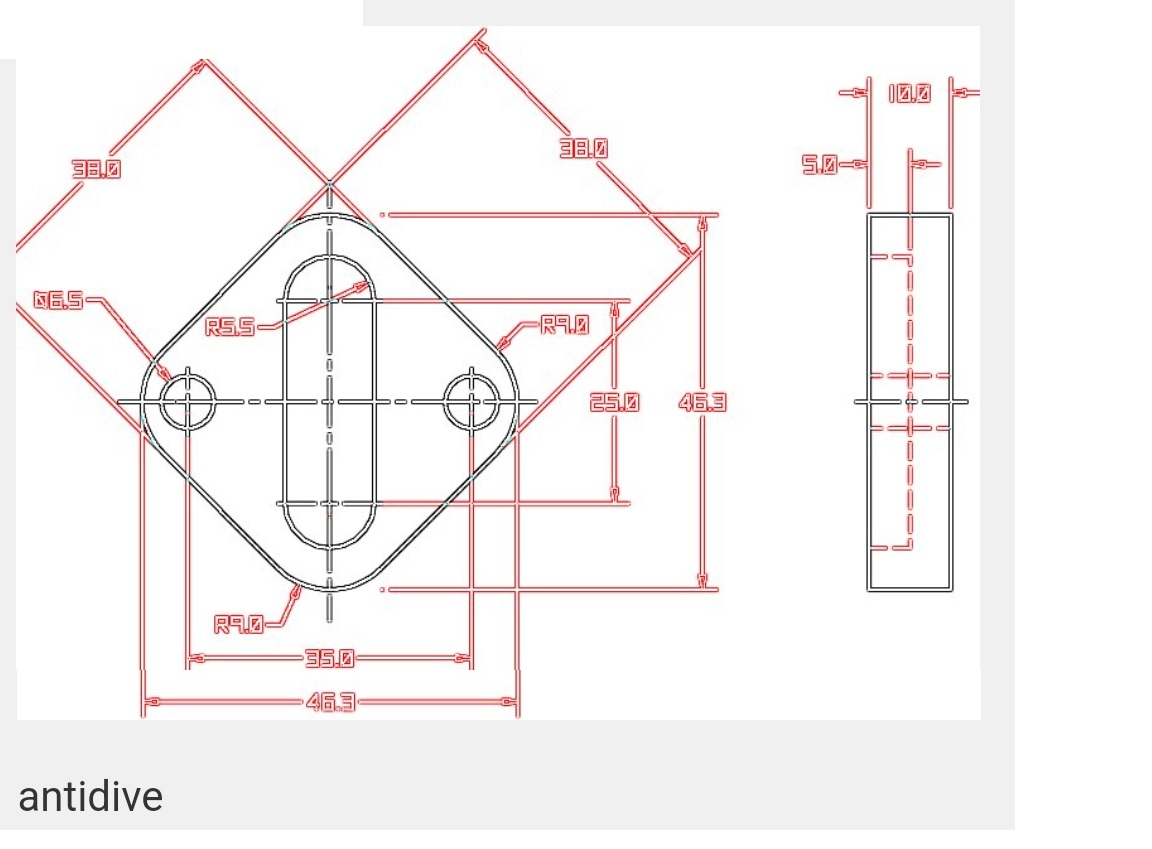

Hey folks, as part of my personal resto project I'm looking at new front and back suspension, I've already decided on fitting a ZR7 shock to the rear based on info here and 750turbo but I'm seeing a lot of differing info on the method for converting the front to straight rates. Before I go and buy a bunch of stuff and spend a few 12 packs and hours of time on this, is there any reason why I shouldn't/couldn't delete the crossover, run a line directly to each caliper, plug the fork hole with either a set screw or weld, and plate over the holes at the bottom?

I assume you are talking about the anti-dive braking circuitry at the bottom of the forks. If so, many folks say it is not worth the trouble and ditch it. However, if you like the way it performs, then there is no shame in keeping it.
If, on the other hand, you are talking about the air adjustable feature at the top of the forks that was popular on the LTD and CRS series (I did not know it came on the GPz, too) then I vote for some quality springs and fork oil and ditching the air assist feature. The system is easy to over fill and it puts unnecessary extra pressure on the seals.

I ditched the air assist on my 750, and installed Sonic straight rate springs instead. A huge improvement.
For the anti-dive, you can remove the mechanisms and fashion a blank off plate. Just be sure to mill a connecting passage between the two holes in the fork, otherwise the damping will be very stiff.

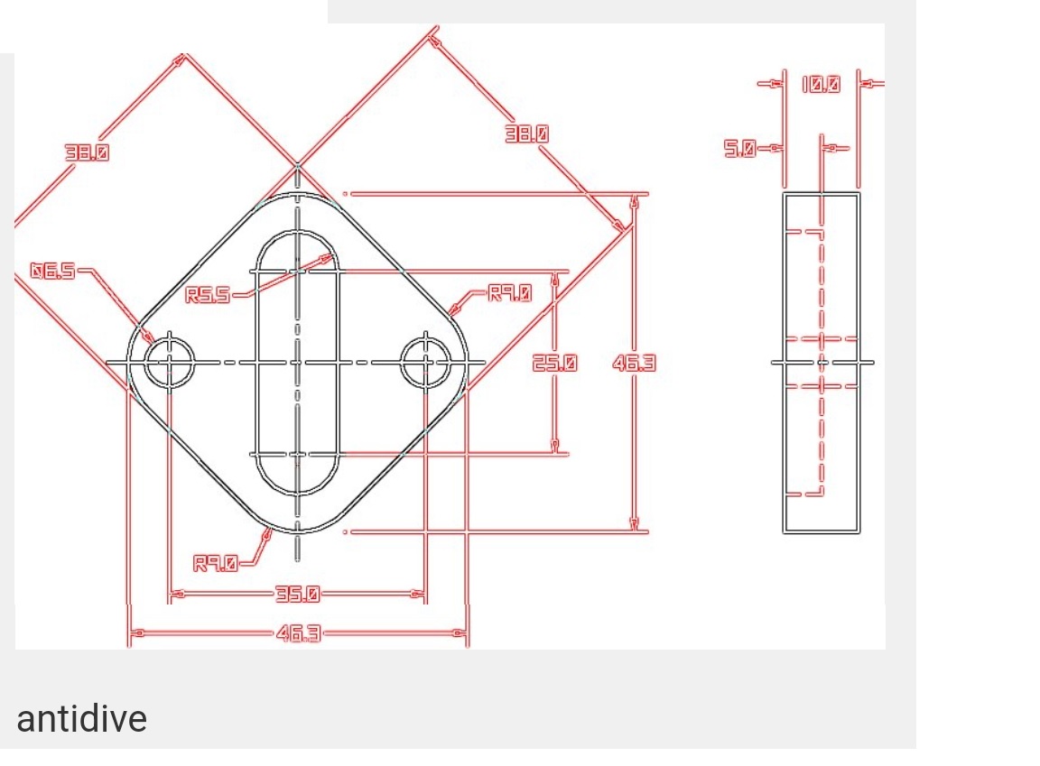

@moizeauHighly appreciate the drawings, will make it much easier to create the plates in the coming weeks. I'm now finding it rather difficult to find fork springs for this bike too, not that I need them immediately as it has been turned into a stripped frame for refinishing but anyone have a good recommendation for them? Also taking opinions on how to close up the air balance holes in the top

28 May 2026 16:45The side holes are my concern. I saw people mentioning set screws but that seems like it would interfere with the springsOnce you have fitted progressive springs can’t you replace the valves with bolts ?
I haven't opened the forks yet though so maybe they don't actually matter?
