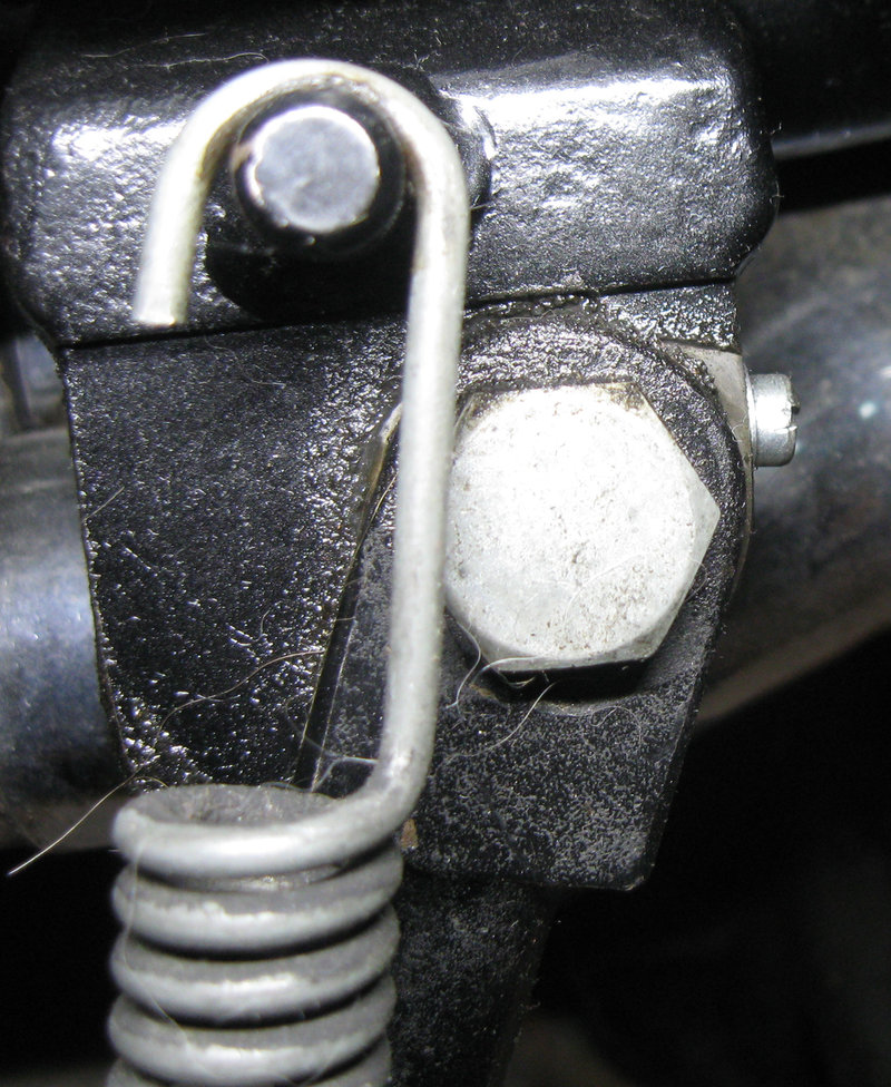

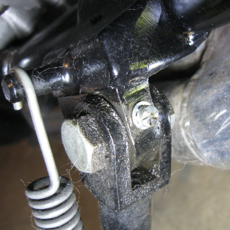

Had to make a stop for use with a 4/2 Jardine system on a Z1, to keep the sidestand from constantly riding directly on the left side collector.
Drilled a small hole in the sidestand bracket slightly above the pivot bolt axis, then turned a self-tapping screw with a thick head into it. Makes an adjustable stop. It's been in service for decades, so the head has been mashed slightly flat. A half turn or so out compensates.
First pic below shows the screw head in side profile at about 2 o'clock from the pivot bolt axis. The head was originally slightly rounded, but has been mashed somewhat flat by sidestand pressure.
Second pic is directly facing the screw head. Lock washer under the screw is only to hold the adjustment a half turn out from seated, as pressure from the sidestand won't let it go move anyway.
