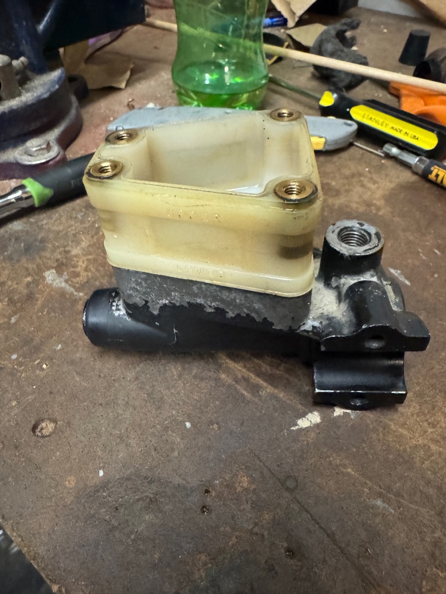

Is the plastic portion of this master cylinder removable for painting and/or powder coating?

Yes, it's removable. Have handy a nice #2 JIS phillips bit or screwdriver for removing the two screws at the bottom of reservoir. You want to properly remove them!! They are a bear to remove if you bugger-up the threads. What appears as a trapezoidal plastic bit visually it's actually round underneath and uses an o-ring for sealing. Might want to solid mount the master to something and use an impact driver to remove those 2 screws. Square and sharply without letting the #2 bit wander. They can be a bear to remove, just saying..

You were right about the o-ring, but the body is not round.  Life sort of got in the way and the motorcycle just wasn't a priority for the last 15 years, but now that I'm an empty nester I need something to spend my time on to stay out of trouble.  Hopefully it gets the love it deserves.

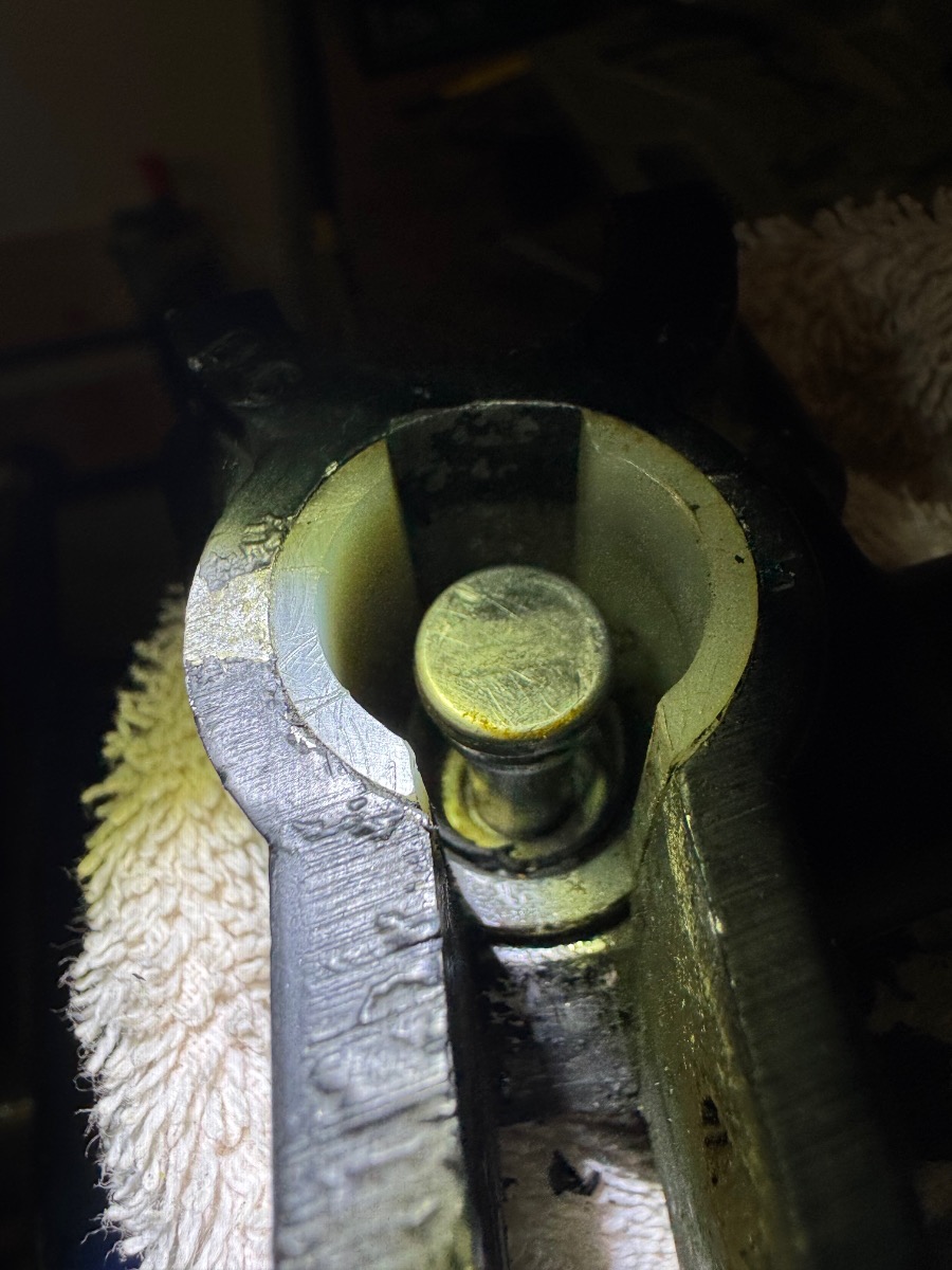

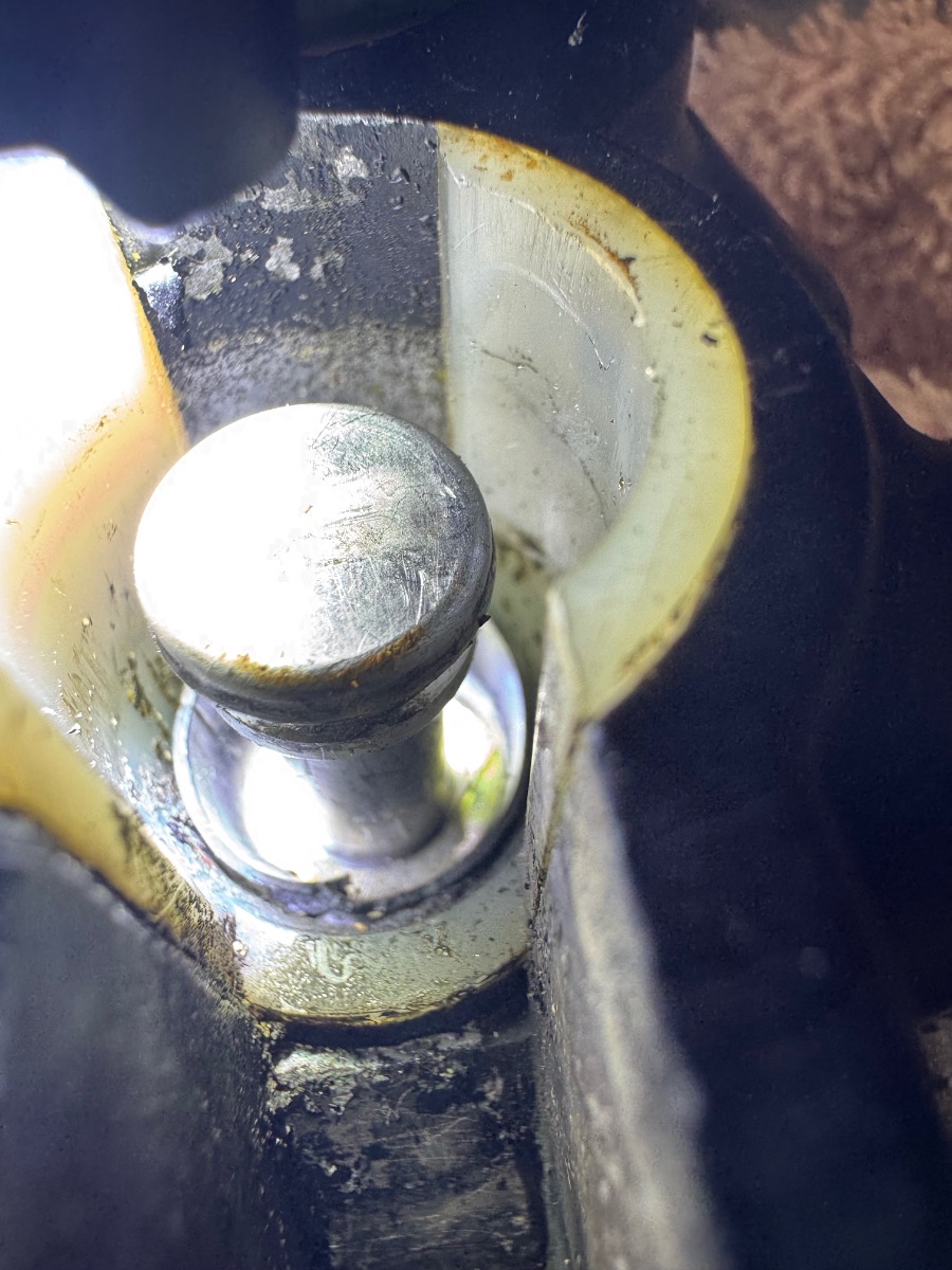

What am I looking at here.  Does that plastic part need to be removed / pulled out in order to get the plunger out?  It almost looks like the outside boot cover is tucked underneath everything because I had to tear it out and there is still pieces of it left.

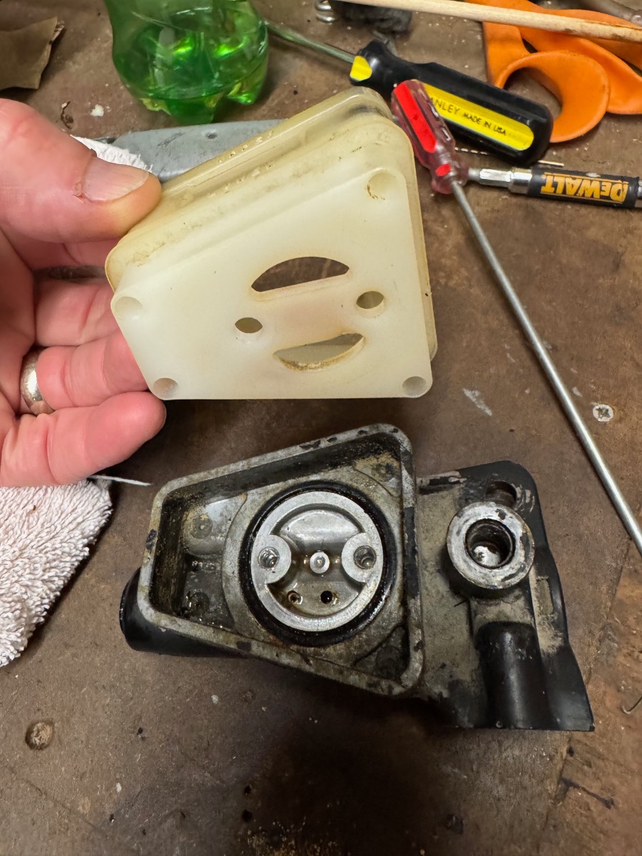

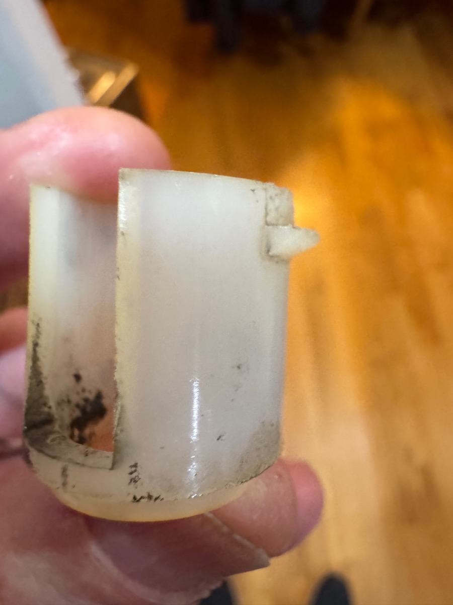

posting photos for others in case they have the same need.  There are plastic clips/tabs
This browser does not support PDFs. Please download the PDF to view it: Download PDF
at the top and you can carefully pull them towards the center. Then you can pull the part out.  Evidently this is what holds the plunger in (instead of a circlip of sorts).  I also found a parts diagram for it.
