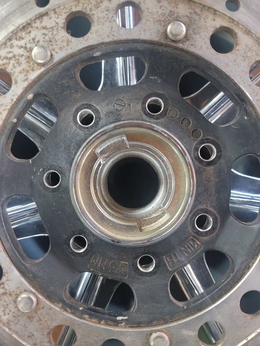

I need help identifying this wheel
  • clagrow68
  • clagrow68's Avatar Topic Author
  • Posts: 44
  • Thanks: 14
31 Jan 2026 17:47 - 31 Jan 2026 17:51
#921095

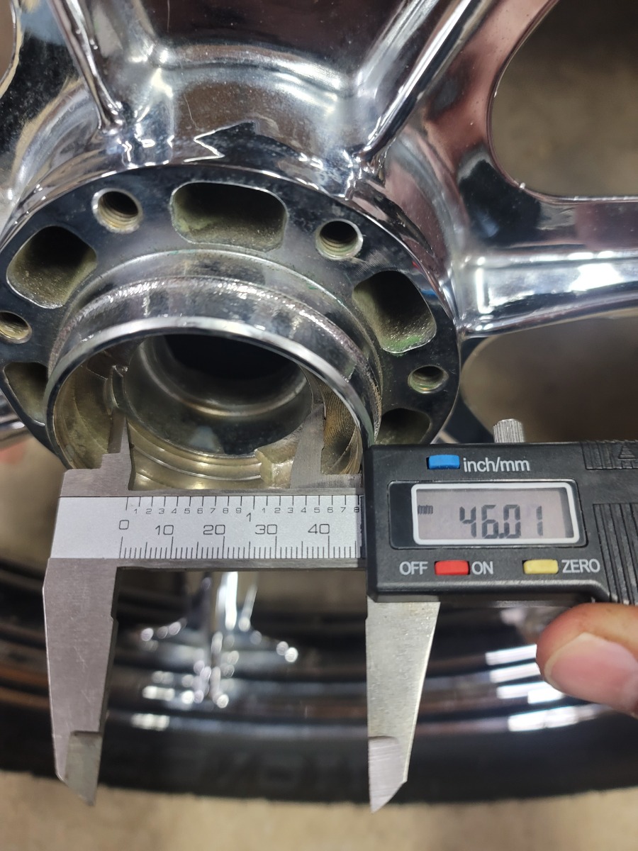

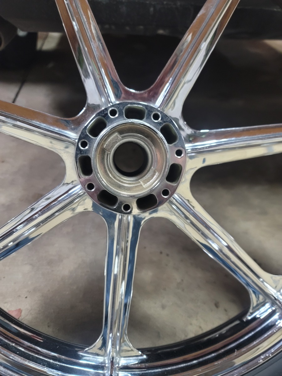

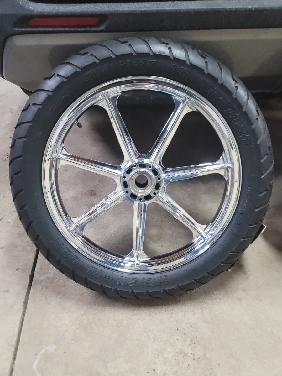

Not even sure it is for a KZ but it matches my rear one so I'm trying to identify it to be able to find rotors and bearings.  Any help you can be is appreciated.  By the way, no stamping at all on it.

It looks like a stock kawasaki wheel that has been smoothed and then chromed. 7 bolt disc mount and size make it an early 80's z1000 thou front wheel. So maybe z1000 J, R, R2 etc.

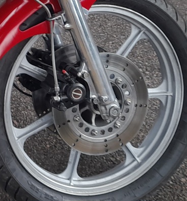

I have a wheel from an 81 GPZ1100 and it looks like the one in your picture but the diameter of the 7 holes on this one is much smaller.

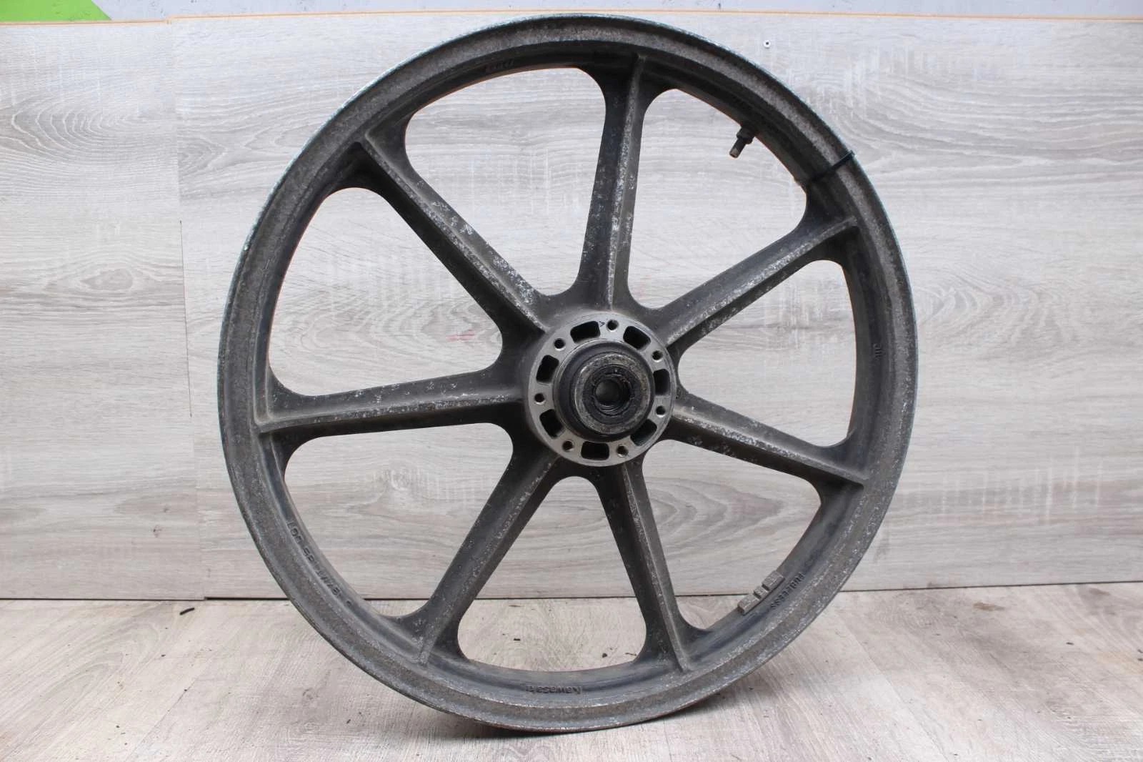

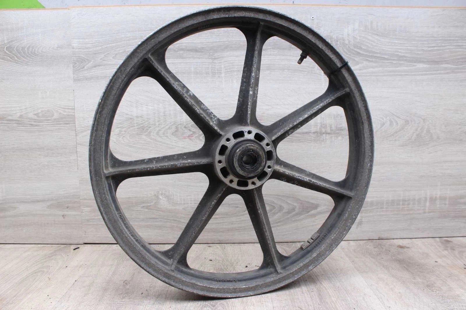

Looks like a 79-80 KZ1000ST - is it 1.85 wide ?

It looks exactly like that! BUT, it is 3" from lip to lip edge.  I'm near 100% certain that you nailed it.  Now to figure out what all I need to do to make it work with a n LTD front end.  THANKS Wookie!

As usual wookie nailed it.  Now I have to sit down and figure bearing and axle and Speedo drive issues and details of getting it to work on my 78 KZ1000 LTD I want to keep the stock forks.

I got a hold of some rotors for a '79 KZ1000ST and they fit perfectly.
