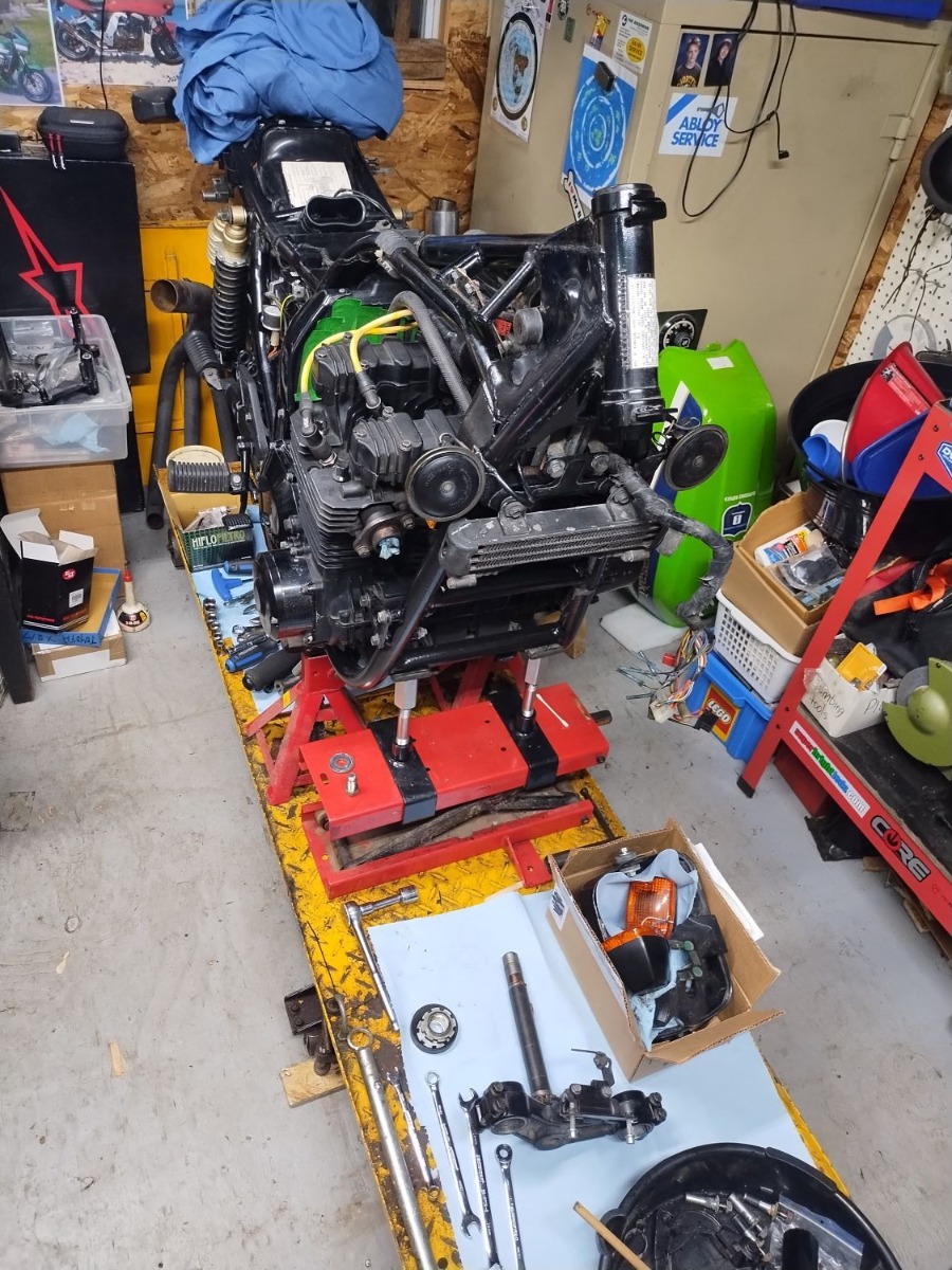

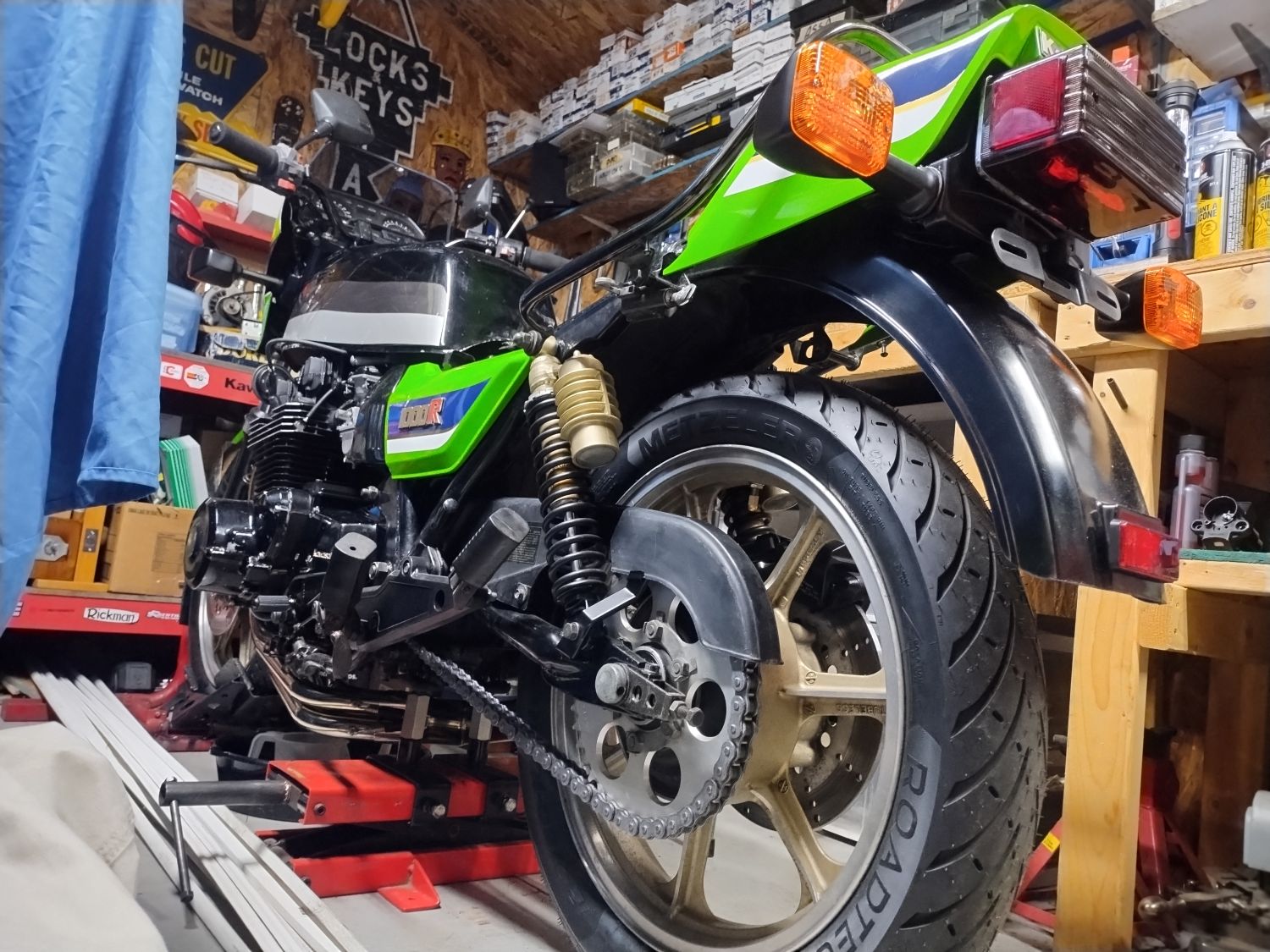

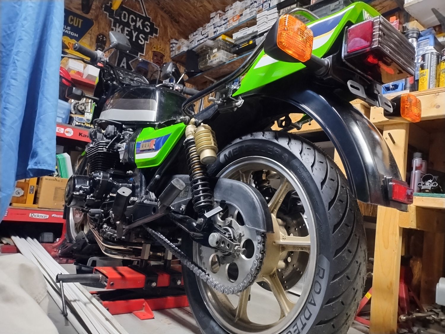

Same issue on my KZ1000.
No center stand.
I find this little red stand works well.
The two lifting points are adjustable, have rubber topped flats.
I have different length threaded rod to use the stand on other bikes.
It's currently holding the bike up below, by the center stand mounts, althought she never came with a center stand.
Here, holding the front end up, wheel off:
No center stand.

Wookie58, a paddock stand dosnt fit, the exhaust gets in the way, and im not taking them of just to check the chain etc.
Rstnick, i have seen those stands before, so i might give that a try. I have found a stand for sale from z power in the uk, but he wants 200quid for them. Yeah i think i'll give one of those a try.
