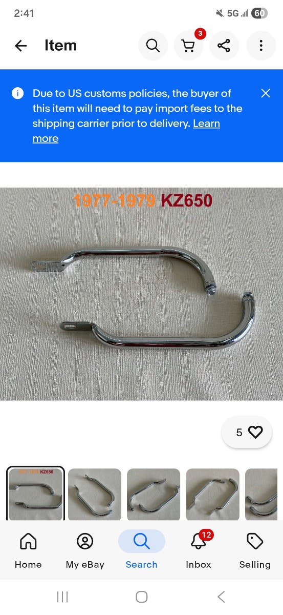

Yeah I think the 650's grab bars are around 2" longer than what would fit a 750. The crazy thing is that I have seen grab bars like that on my same bike on the internet...frustrating!

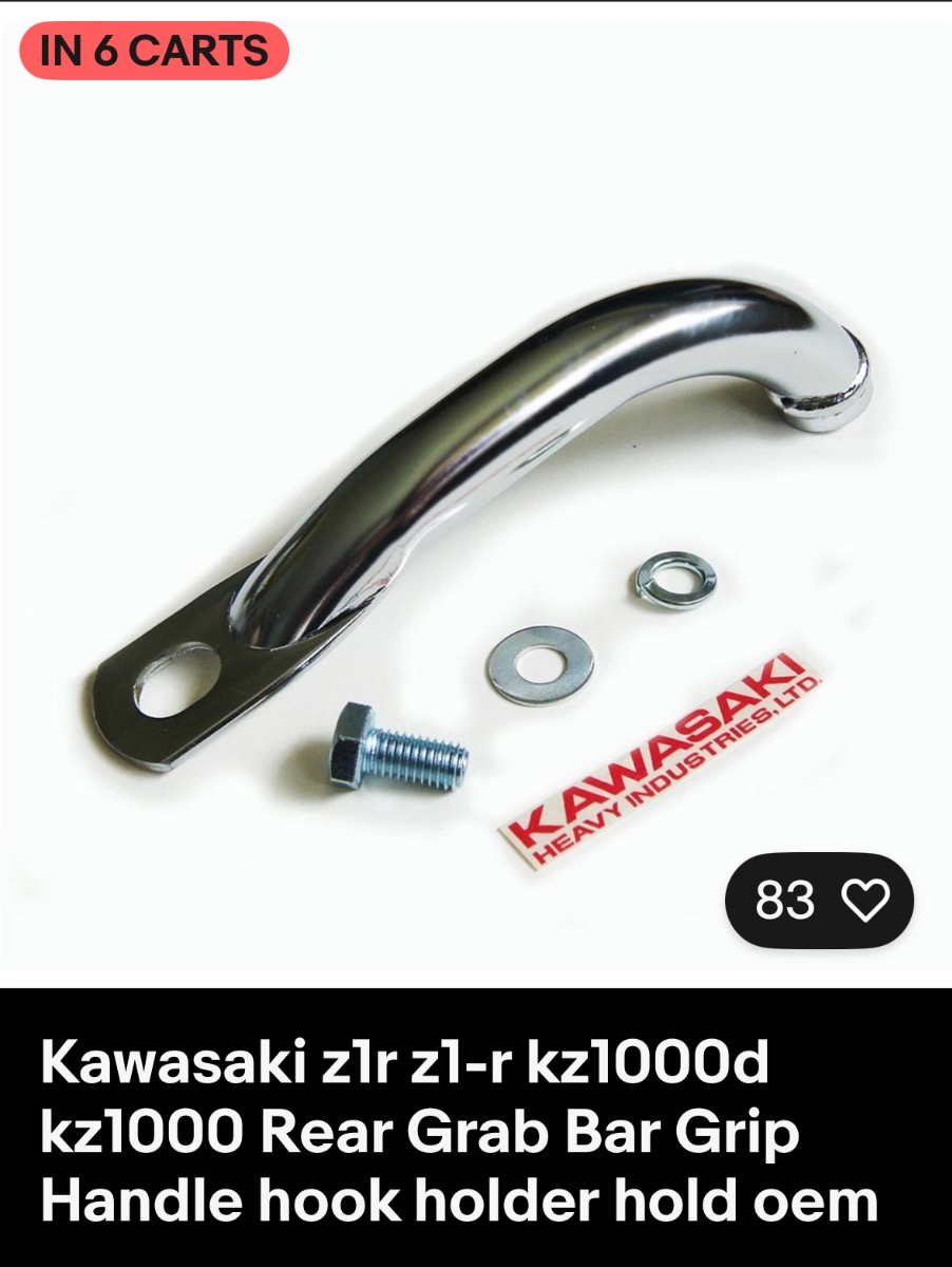

Take a look for a Z1R grab bar.  They’re very similar, and although I don’t have measurements,  they appear shorter.

The passenger grab rails on the 650 SR models are shorter than the 650 B/C models by about 1" if that helps. I think I may have the exact measurement around here somewhere as I bought a set by mistake years ago.
Mounting distance on B/C model rails is 9-1/4" so on the SR about 8-1/4" (need to check)
What is the distance between the mounting points on the 750?
1978 KZ650B2 modified project
Last edit: 31 Oct 2025 06:24 by Injected. Reason: info
  • Injected
  • Injected's Avatar
  • Posts: 1829
  • Thanks: 1278
Re: Will the 77-79 KZ650 grab bar fit kz750???
31 Oct 2025 06:26
#918549
I have written down the SR grab rails are 3/4" shorter, so they have 8-1/2" mount centers.

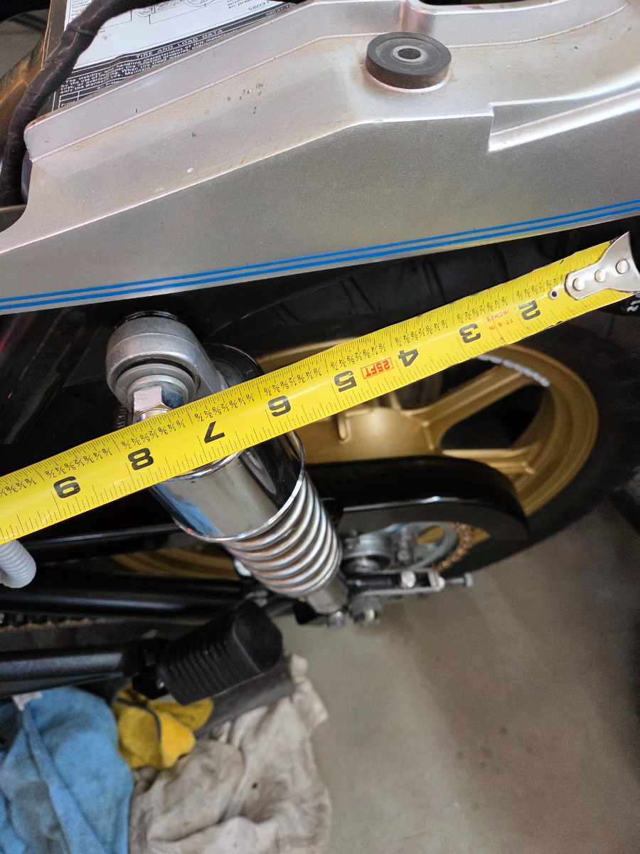

Center to center is 7.5"
