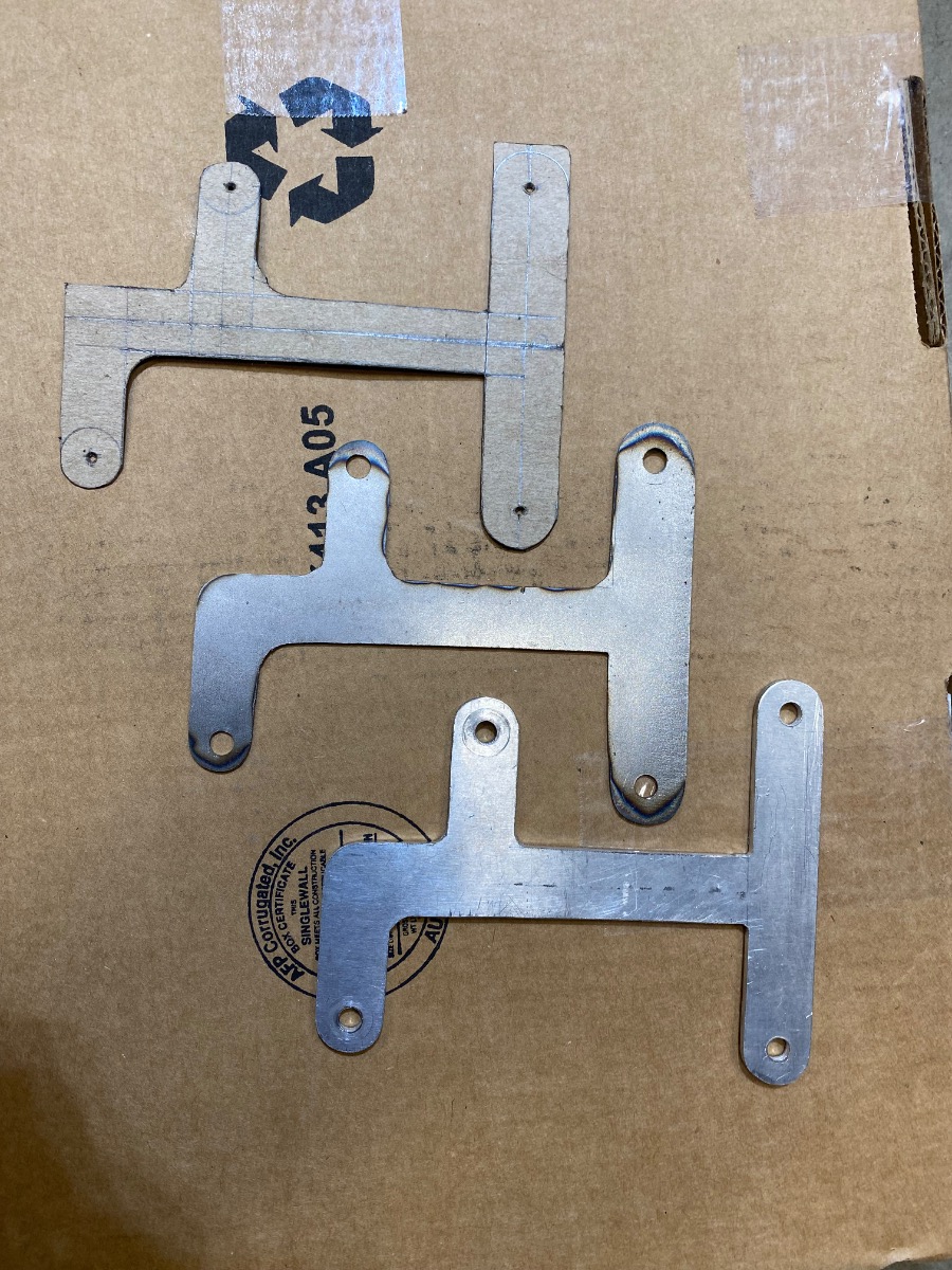

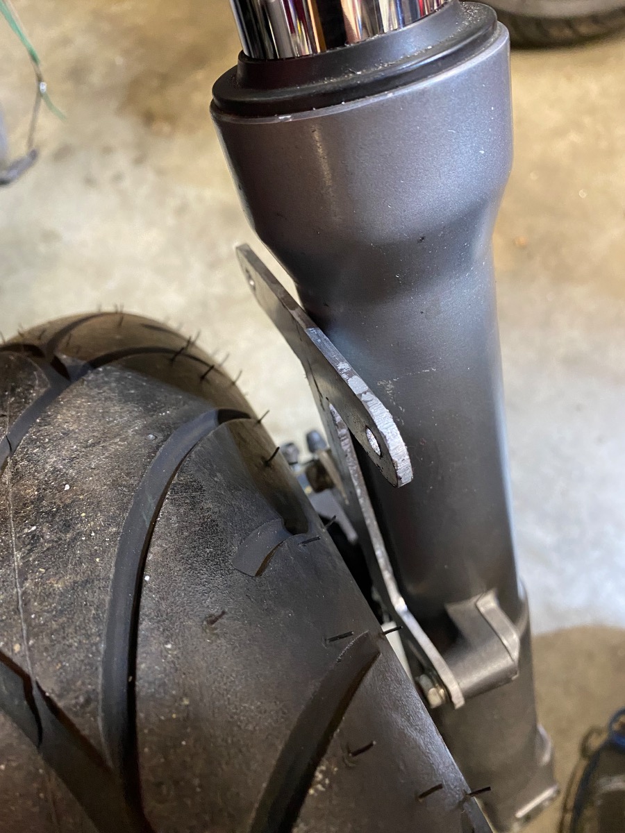

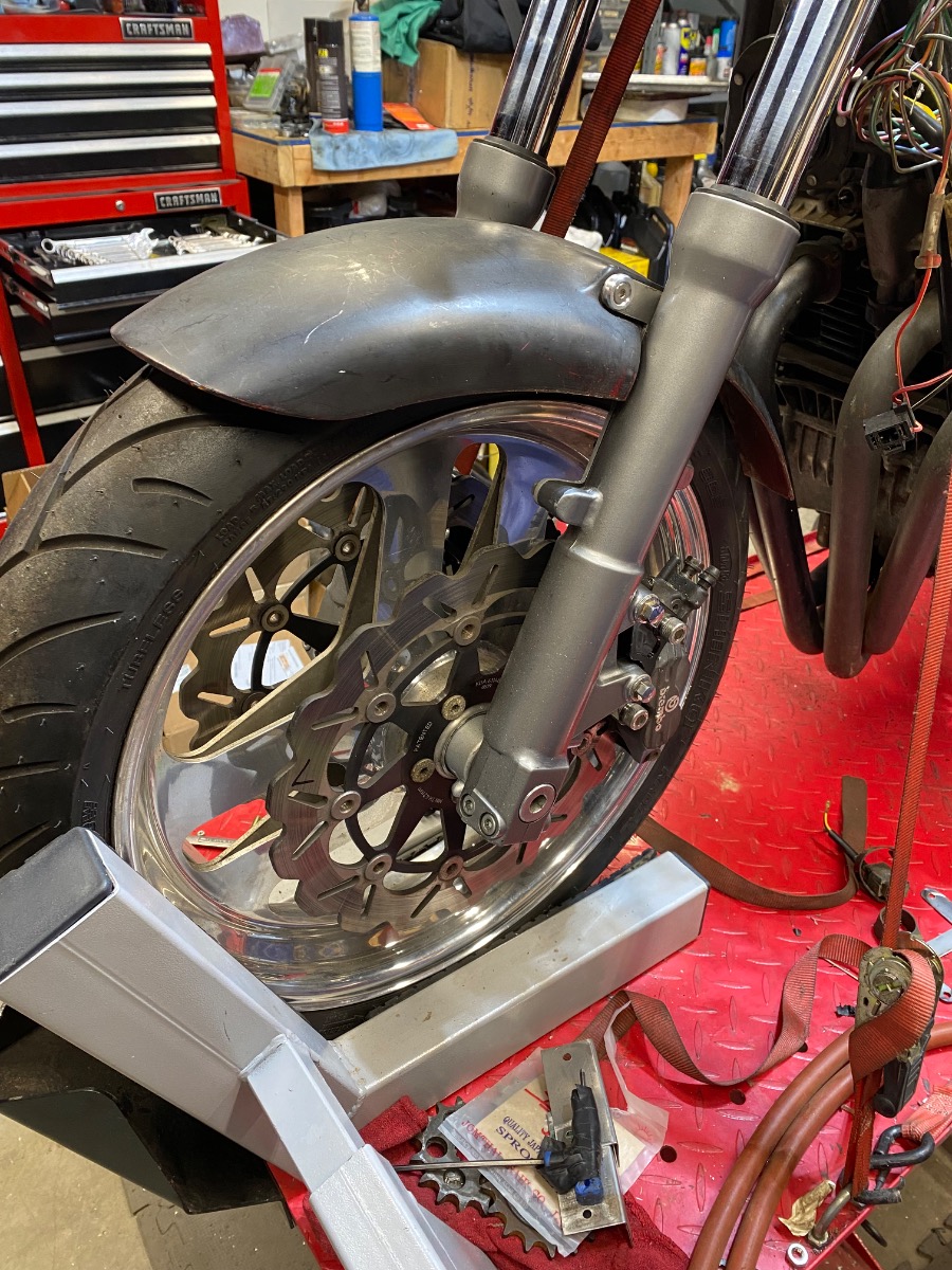

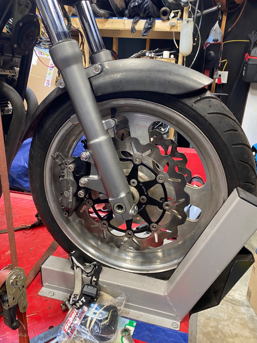

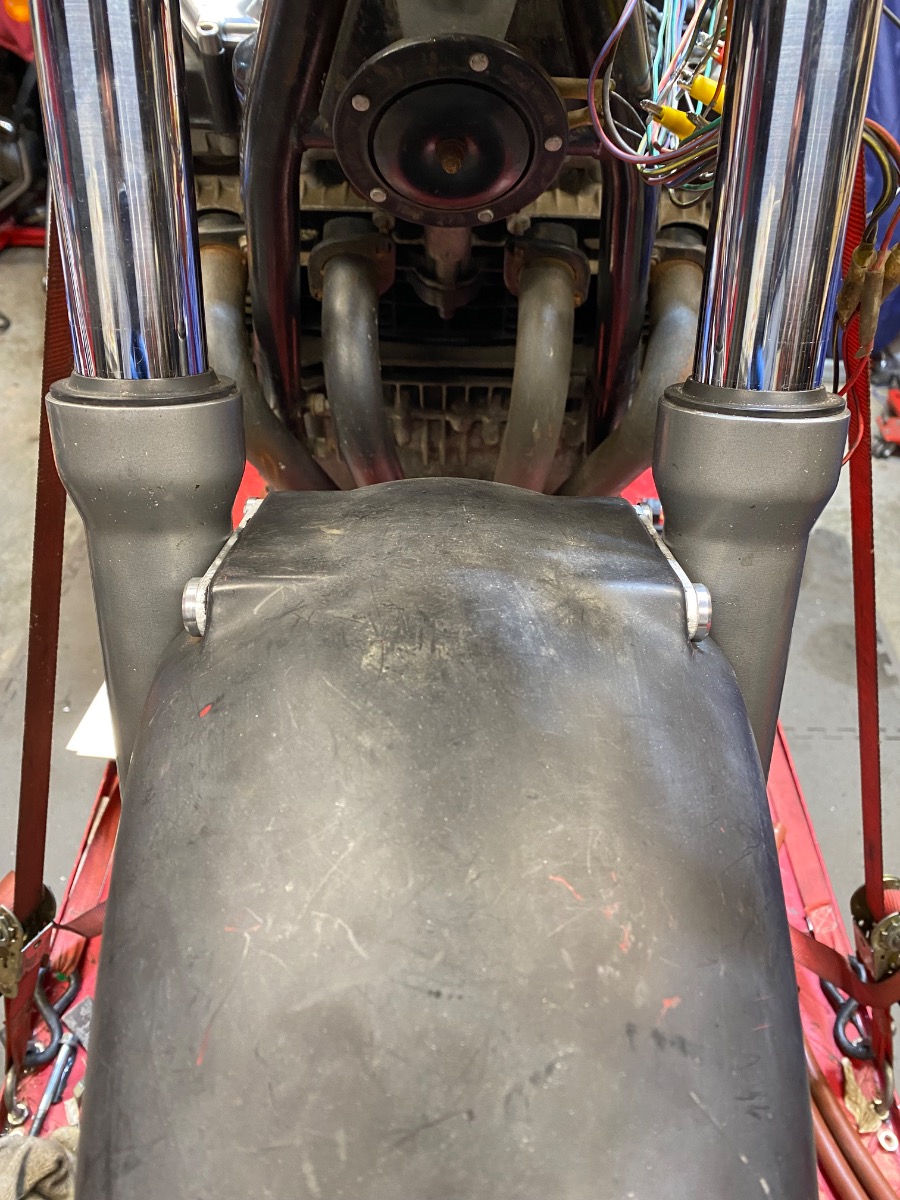

Not quite the same parts combo but I used a 95-97 Zx6R front end and an early CBR900RR fender on my Kz650. I made a couple aluminum mounting brackets. I’m sure that you could do something similar.

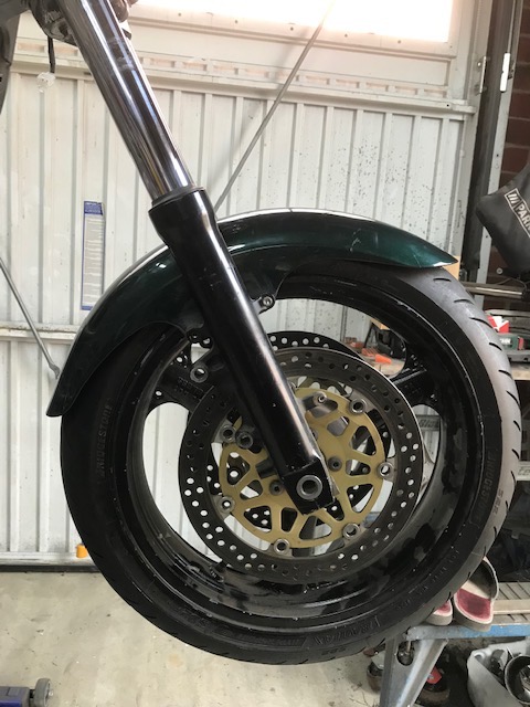

Re: Front Fender
27 Oct 2025 12:20

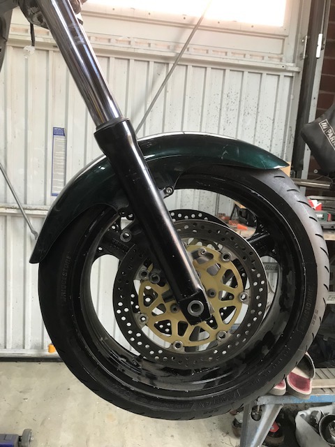

I am using a Zephyr 750 item with ZX9R forks. If you look back to page 20 something of my build you can see the mods I did to the brace and fender (not extensive)
