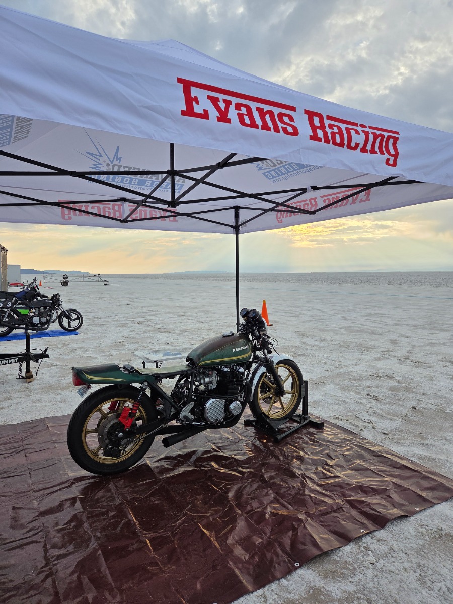

I am looking for some higher rated tires and I am hoping some one here can point me in the right direction.
120/90/18 and 100/90/19 on standard KZ1000 18/19 rims. - I am hunting for W rated or Higher, I have V but need to be rated above 160mph.
Any one have any suggestions?

We joined the USFRA 130mph club this last week with a top run of 139.765 (almost broke out ) on the 1 mile track. We are going for the 150mph club on the 2.25 mile track next year.
We have more in the engine and room to gear down in the rear.
I can't say we will see 160mph plus, but I do know tech won't pass us until I have tires rated W or better.
