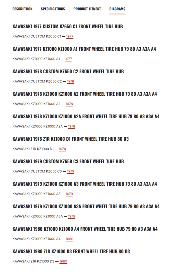

Sorry, doubting Thomas here!
The same part number wheel is used across many different models, and none of those, to my knowledge, use a 2.15 wheel. I suspect the front is a common 1.85 x 19.

I do not know about the width of the wheels. The parts lists on the Kawasaki.com site indicate an 18 in tire is used on the D1 in front,and a 19 in tire is on the front for D3. I do find it of interest that there is no info on the size of the wheels?
www.kawasaki.com/en-us/owner-center/parts/144283/1978/KZ1000-D1
www.kawasaki.com/en-us/owner-center/parts/144332/1980/KZ1000-D3

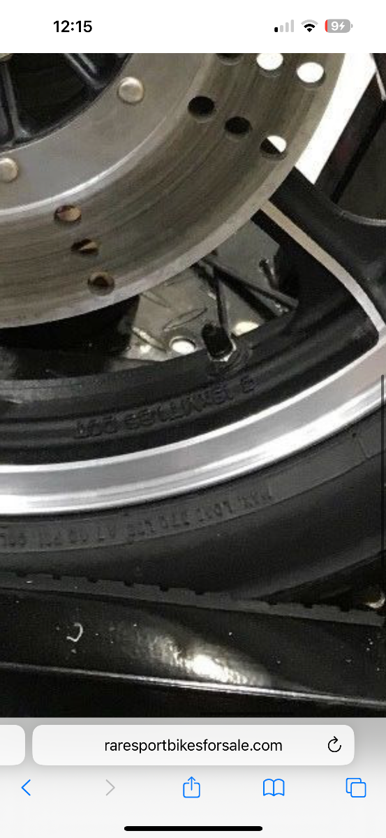

31 Aug 2025 09:19Ed, you are the winner here. It is 19x1.85. I looked at a more pristine example of the D3 and the wheel is stamped 19x1.85
