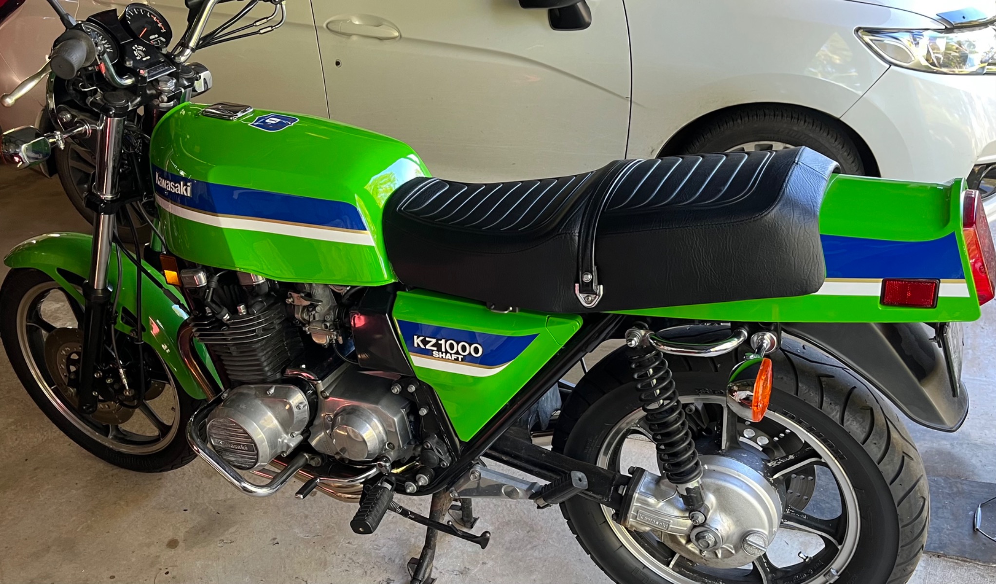

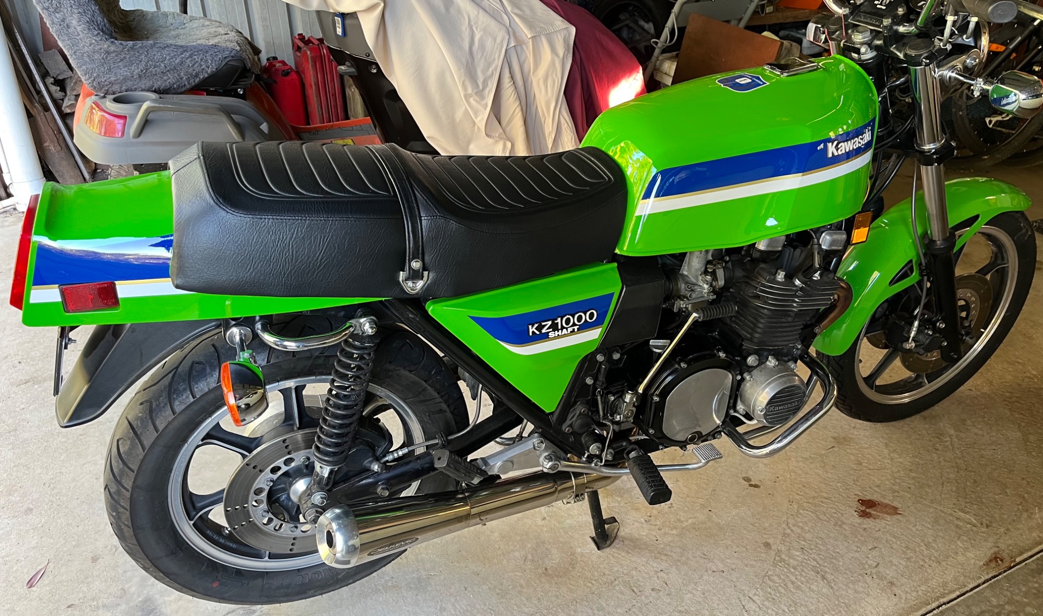

Good afternoon from Ausš¦šŗ,
project near complete, Iām turning my kz1000st into a ELR tribute,
I want to put a fairing on & my question is would a Z1R fit as the ST has a 7ā headlight,
the EMGO style doesnāt fit unless I get new bars, master cylinder, shorter cables etc etc,
I am also leaning to a āSTONEā style as well, itās just I havenāt seen a ST with a front fairingĀ

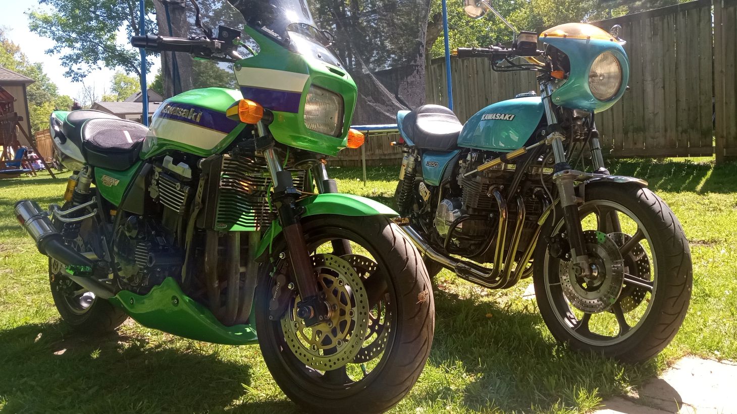

Your 1300 looks great!
Have you got a picture of the front of the bike, showing the headlight?

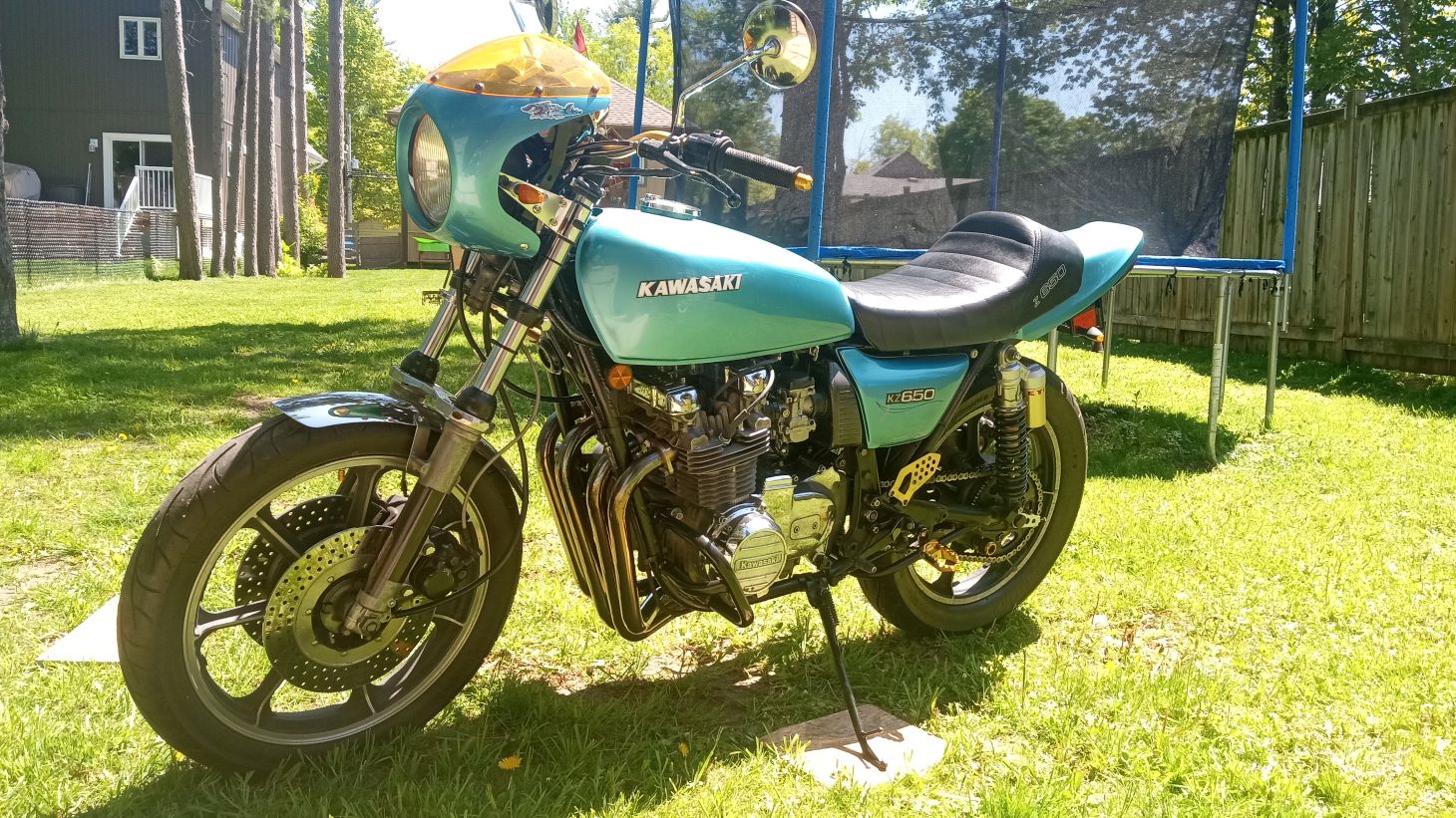

My 1978 KZ650 has a 7 inch headlight.
I bought a cheap eBay fairing.
This seller had many different color combo with different windshield colors too.
Mine painted blue to match, with yellow windshield.
