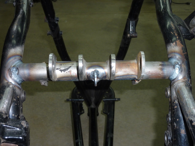

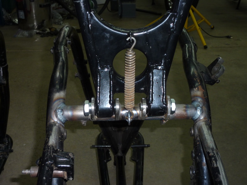

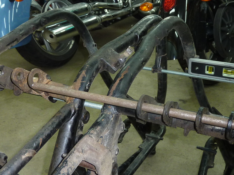

I had the same thing on one of my 75 Z1 bikes. Bike came without a center stand so I thought I should check one on the bike. Hit the pan. So here is a side by side comparison of a good frame to the 75 questionable. frame They were lined up side by side and you can see the misalignment on the left frame. I ended up removing that frame member and welding in one from a good doner frame.

Thanks for posting photos.
Yours is offset more then mine.
I've owned 15 z1's never seen this.
Frames were welded in jigs, wonder how this happened.
