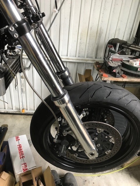

You can buy the fittings and line from "Goodrich" etc and make your own lines (this is what I have just done) Not sure ref suppliers in the USA, I'm sure others will advise
