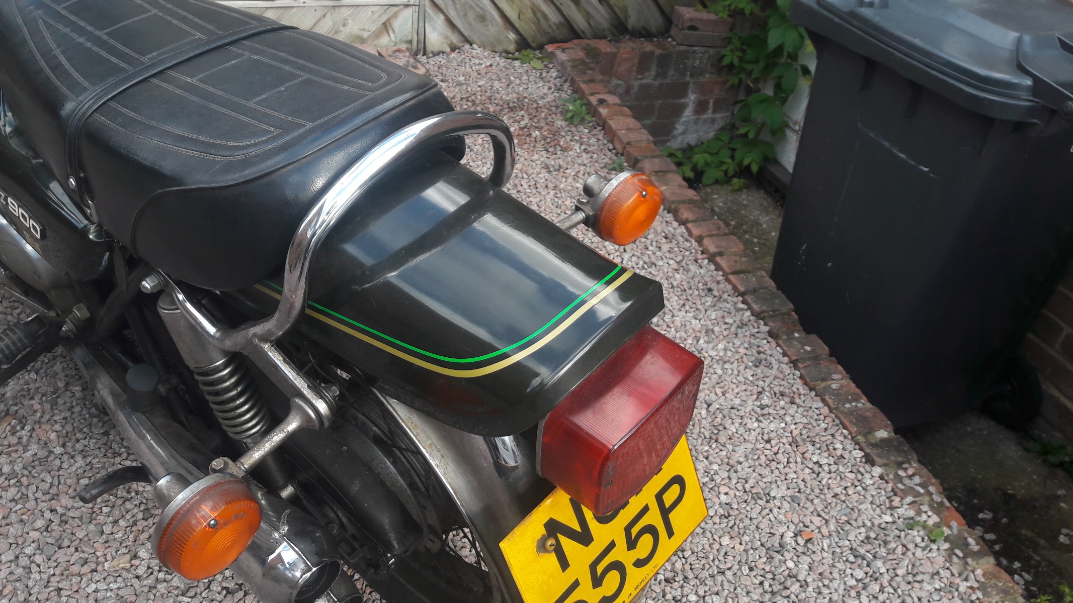

Re: Grab Bar help. Oem aftermarket I.d.
31 May 2025 15:03
Kawasaki list 73 through 77 900 as 35032-022
77 - 78 1000 as the same number.
But there is definately two tail light / tail piece styles.
This is a picture of a 100% unadulterated 77. If we can find a similar pic of a genuine 73 one we can confirm either way.
31 May 2025 15:25
Well , that's definitely not the grab bar I was talking about. That's a Z900. Not a kz900. Kz900s have provisions for the turn signals in the frame as opposed to the z900 over on your side of the pond. If that also has the same part # my brain might pop.
01 Jun 2025 03:15
Giwill, as sf4t7 stated, subtle changes were implemented along the product line of almost EVERY bit of these Z's but part number remained the same or the Newer numbering system. Concerning the grab rail, generally the waay early ones were missing the 1 or 3 weep holes and it was kinda random when they started the drillings. So any, if you can source an original 35032-022, you'll be correct. Warren showing the 35032-030, was more European. I do DIG Your inquiry!! Most persons seem to only care about shiny. Wait till You start looking for the correct winker lenses, several versions of raised font. Welcome to my world!!
