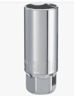

Your damping rod tool is nifty. I use a spark plug socket, with the extension inserted backwards, instead. No welding involved...
The hex on the bottom of the socket matches the hex in the damping rod.

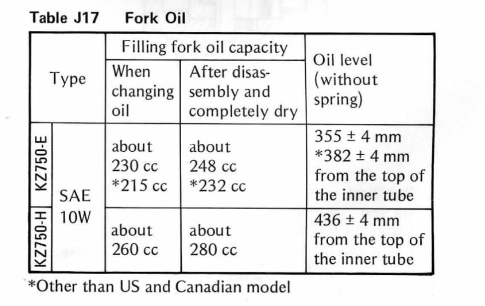

I'm really struggling here to find the correct answer, do you measure the front fork oil capacity, with the forks fully compressed or not ,with or without the springs, the manuals are really helpful.

HI Wookie , I might be just thick here, it does state fully compressed in the Haynes manual, cannot see anything in Kawasaki manual, nor can I find anything specific elsewhere, only a post re Z 750 twin.

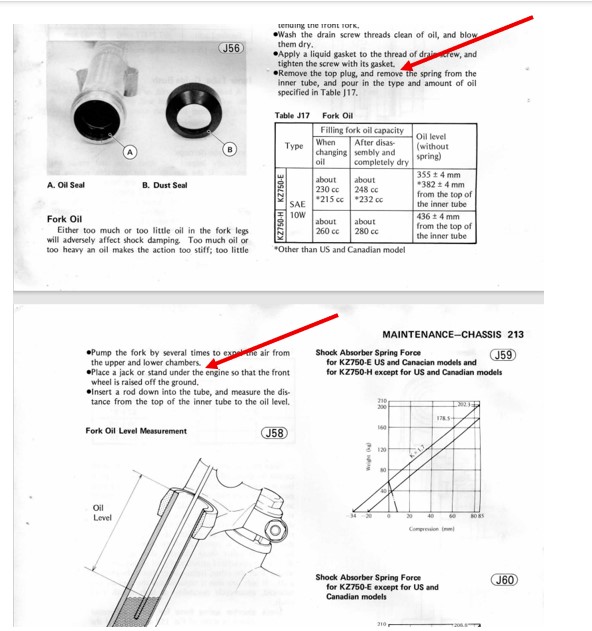

06 Jun 2025 02:09The extract I posted is from the Kawasaki factory manual in the file base. It states spring removed and forks fully extended (also in the filling capacity chart it states "oil level without spring")HI Wookie , I might be just thick here, it does state fully compressed in the Haynes manual, cannot see anything in Kawasaki manual, nor can I find anything specific elsewhere, only a post re Z 750 twin.

Here is what I've come up with, wouldn't have to this would have caused me so much time to get correct, thanks again Wookie.
