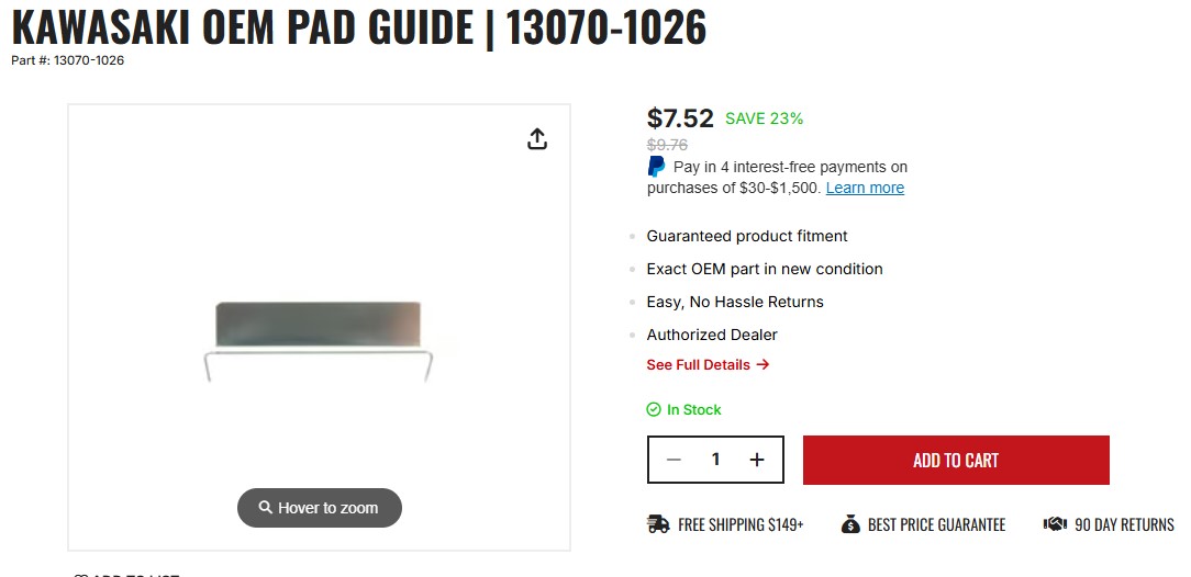

there isn't a drawing for all models. but there seems to be two types of front brake caliper for the 440-Ltd. he's probably referencing the pad guide found on the D5 linked below. guessing.
1984 440D5 Ltd Belt. www.partzilla.com/catalog/kawasaki/motor...front-brake-kz440-d5 . later style caliper.
1980 440A1. www.partzilla.com/catalog/kawasaki/motor...a1/front-brake-80-a1 . early style.

That is it. Piece 13070. I guess it is suppose to have two of them but I only have one.
No matter how hard I try; it always drops out.
I have no idea how it is supposed to stay in there.

08 May 2025 04:41The link provided shows them as "in stock" !!! entirely up to you but I don't think "deleting brake parts deemed necc by the manufacturer" is the best course of action. When it comes to fitting you can put a "dab" of copper grease on the back of the guide to hold it in place while you fit the padsWell since I was missing on for years and the brakes worked great and since you can't buy the slider I decided to leave it out. The caliper is back on the bike and the brakes work great. Thanks

the pad guides clip onto the brake caliper floating slider. one of them oriented as in the diagram. the ss-guides have a smooth surface for the pads to move. if they don't clip in place. try bending/flexing the tabs a smidge. in case it's missing. there's also a pad spring. from memory. the pad spring provides tension to keep the pads and guides in place.
ebaay 235005890333. pic 6.

Thanks. I tried to find them but had no luck. I will definitely be ordering them. And great tip about the grease. Once again I have been saved by this forum.
