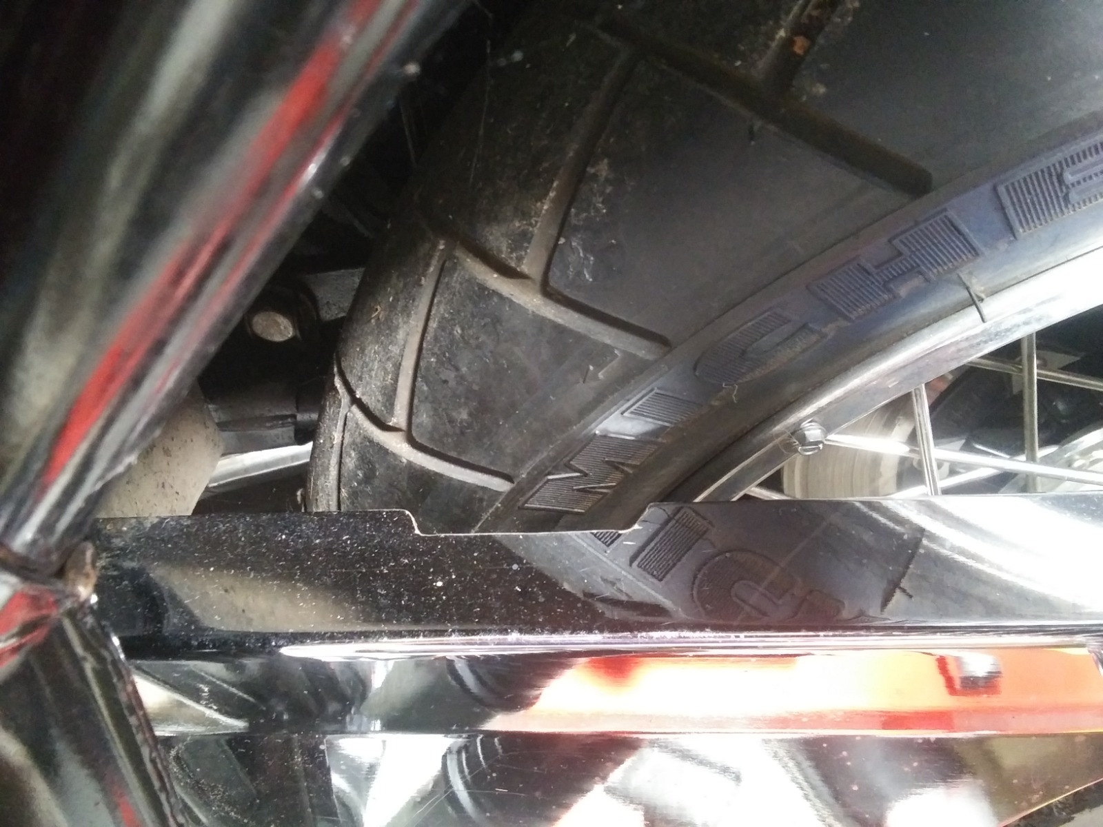

Fast forward to now and I'm building my KZ1000A. Located and restored the similar 2.15-19 front and 3.00-16 Lester wheels with Avon Roadrider Mk III tires, 3.25-19 and 130/90-16. But now the rear tire significantly rubs the chain guard.
This surprises me, as swingarm geometry, chain guard, etc are essentially identical from Z's thru KZ1000's (at least thru early '80's), so I did not expect this. Is it that the newer 130/90's are significantly wider in practice than the old 5.10's or what? Am I missing something?

You need a 120 .

Also keep in mind that a 130 Avon will not measure the same installed width as a 130 from another manufacturer, and may be different from a different line from Avon. Motorcycle tires generally come in 10mm increments, so somewhere between 120 and 140 is 130 territory.

As for tire sizes, while a 120 might help solve the problem, a 120/90-16 Avon RR is not available. There is a 120/80, but the diameter is then down 1.7" do no-go.
As for dimensions, the Avon specs say something like 136-7 mm and it measures very close to this on the bike. Some manufacturers are good with specs (Avon, Bridgestone, probably others), Michelin not so much at least that I could find for their Road Classics for example.
But the dimensions are part of what puzzles me. The old 5.10 tires (it was a Goodyear in this case) measured right about 129-130 mm. And 7mm less width (or 3.5 mm per side) would not cure this.
Chain guards can be replaced or modified, not the end of the world.

The "end width" will depend on sidewall construction from one manufacturer to the other. Your 3.0 rim is bang in the middle of correct rim size for the tyre so I guess the "bulge" determined by the sidewalls is where the difference is coming from. I would re-work the chain guard and call it done

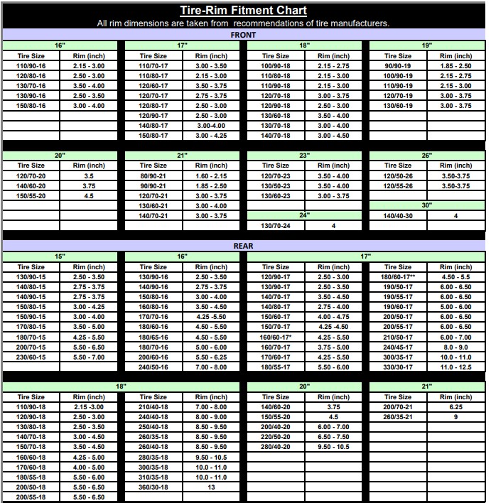

I'm surprised that the 130/90 is rubbing. The factory manual says the stock KZ1000 LTD 16" rear tire is an MT90. Every conversion chart I can find says this is equivalent to a 130/90.
Even Avon shows that same conversion: www.avontyres.com/en-gb/tyre-care/techni...re-size-information/
The 18" rear tire KZ1000 bikes, with the plastic chain guard and the 2.15" wide wheels will not really accept a 130 tire. A 120 is about as wide as you can go. At 130, the sidewall becomes very distorted due to the narrow wheel, and the tire will rub a slot in the back side of the chain guard.
However, the 16" wheel is wider and the LTD bikes did not use the plastic chain guard. It had not occurred to me before now, but I'm guessing the LTDs used the chrome metal chain guard, which did not have a back side, primarily because they needed to make more room for the wider tire. I never put that together before.
In any case, is it possible that you swapped or moved around the spacers on the rear axle after you put the new tire on?
Another thing to check is that the wheel is correctly aligned and straight. It seems like an incorrect setting of the axle adjusters could make the tire rub.
