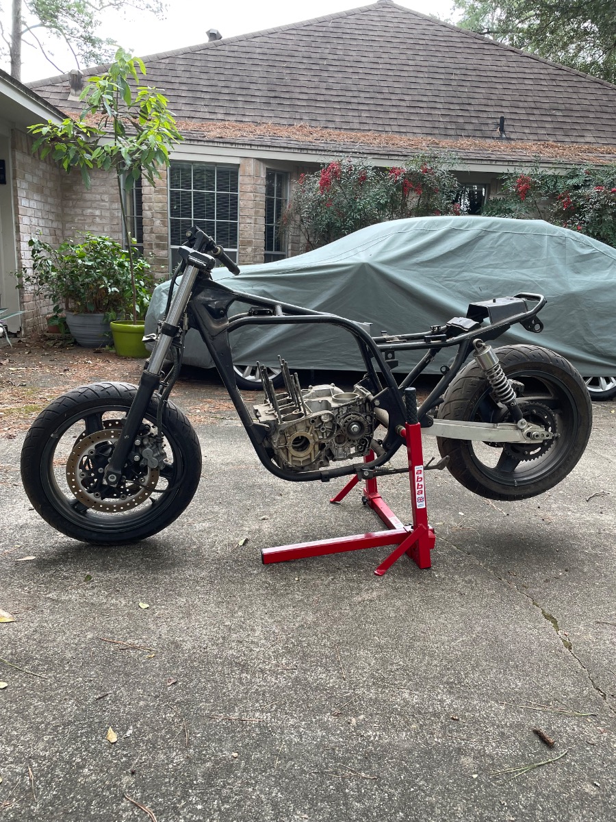

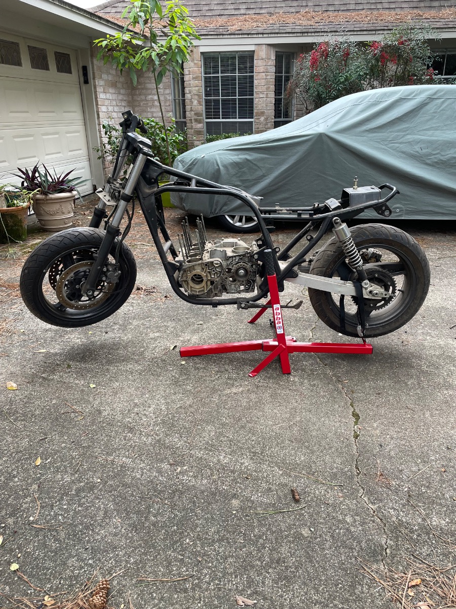

Kawasaki never put a center stand on the ZRX. Now and then when I am on the road, I fling a curse or two at the company. For home maintenance, I bought an Abba stand. It is one of my favorite tools. My KZ is loosing its center stand because of its aftermarket exhaust and other mods. Abba did not list a kit for the KZ, but I sent them the measurements of the swingarm bolt head and nut, and they made a kit so that I can use the Abba on the KZ. I also bought the optional bit that allows me to raise the front at the same time.
If you are going to ditch the center stand, I recommend considering the Abba option.
