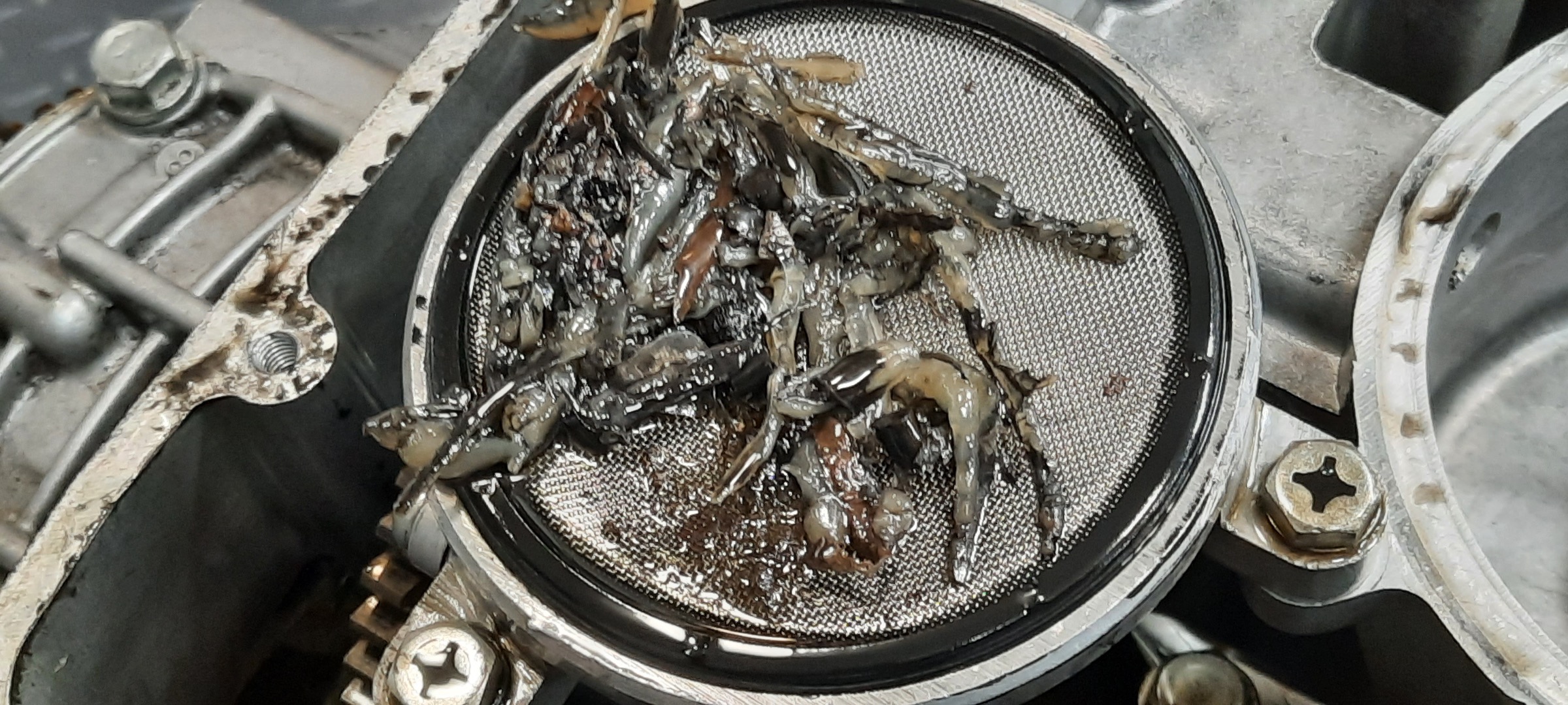

Please tell me you'r a better diesel mechanic than the one who rebuilt this engine using a ton of RTV. Sorry I couldn't resist

10 Apr 2025 00:40This was obviously an "oil strainer" efficiency test - it passedPlease tell me you'r a better diesel mechanic than the one who rebuilt this engine using a ton of RTV. Sorry I couldn't resist

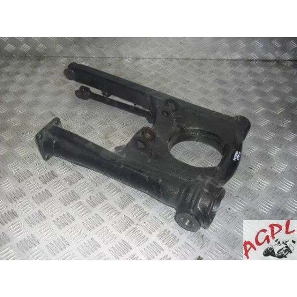

10 Apr 2025 01:53Am I right in assuming you simply want to make the 650/750 shaft drive ?I prefer shaft drive due to cleanliness and lower maintenance.
I have a 88 ZG1000 for a parts bike. Is it possible to swap that rear end into a '81 Ltd 750 or a 83 CSR 650 ( 650 runs but is stripped, 750 is complete but the is engine locked up) WITH OUT splitting the engine case?
I'm a diesel mechanic so I'm sure I can do it even if I have split engine cases open I just don't want to get that deep into it.
Assuming the ZG1000 swingarm will fit between the frame spars (unlikely) you will also need to do a significant amount of fabricating to convert to the ZG mono-shock back end or convert the swingarm to "twin shock" which will also involve some creative fabricating as the swingarm encompasses the shaft drive (pic below) and is likely to be asymmetric. You will also most likely need a "custom" driveshaft along with a motor strip to install a shaft drive output shaft in the transmission. If all you are trying to achieve is a shaft drive 650/750 I would suggest selling all that you have and looking for a GT/Spectre 750 that is factory "shaft", open a cold beer and "call it done" Don't get me wrong, I love a good project and a bit of modification where the "output" justifies the "input"
