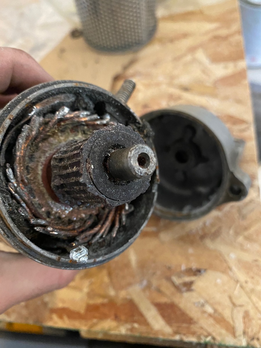

Well cool. I just drained and refilled it. I didn’t change the fork seals. I’ll put this with the other strange and unusual things I’ve come across with this bike. No wonder I got it for a song and dance. Y’all should see the starter….

26 Feb 2025 02:13 - 26 Feb 2025 02:58Has the "commutator "exploded" ??Well cool. I just drained and refilled it. I didn’t change the fork seals. I’ll put this with the other strange and unusual things I’ve come across with this bike. No wonder I got it for a song and dance. Y’all should see the starter….
As always, thanks everyone!
-Tom
If the starter clutch isn't disengaging correctly this is what happens. The starter is geared at approx 8:1 so 2400rpm at the starter = 300rpm engine cranking speed. If the clutch doesn't disengage once the engine fires then the engine drives the starter motor at a 1:8 ratio. This means 6000rpm engine speed = 48,000rpm starter speed, at which point centrifugal forces pull the segments out of the commutator (or the bearings seize and lock the motor) A lot of guys don't understand the potential consequences of a faulty starter clutch !!!!

Excellent remedial lesson! Lol. No, it did not explode, all segments are intact. And the starter clutch is working perfectly. Long story. It all started with the battery not charging. Stator faulty,(10acv output and over 10ohms). So that led to disassembly of the cover.That led to my other post about the case being beat up, which I believe I solved that mystery. So while I was in there I figured I’d freshen up the starter, new o-rings, clean the com and new carbon brushes. I noticed the retaining ring on the output side was bent RED FLAG and grease from the output shaft. RED FLAG. Upon disassembly of the starter, some previous “mechanic” decided to (over) repack the reduction gear box. Which in turn pushed the grease past the seal into the electrical side, up through the armature and coated the carbon brushes. So yeah. It’s been that kind of project.
