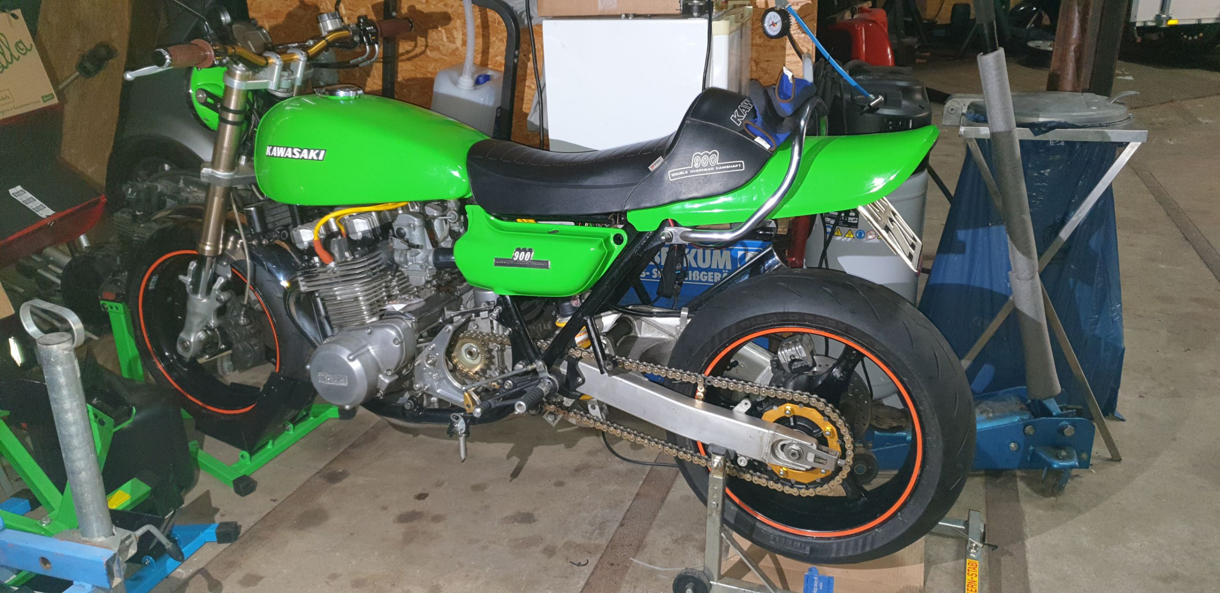

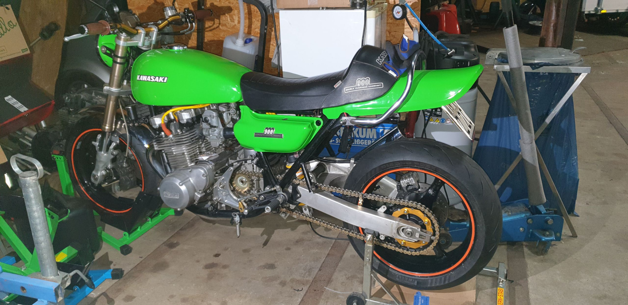

I use only DID chains and JT sprockets ,(exept the offset sprockets), good quality and collection to setup the final gear to wheel ratio.
JT sprockets offer an online chart with sprocket dimensions for a cross reference.
