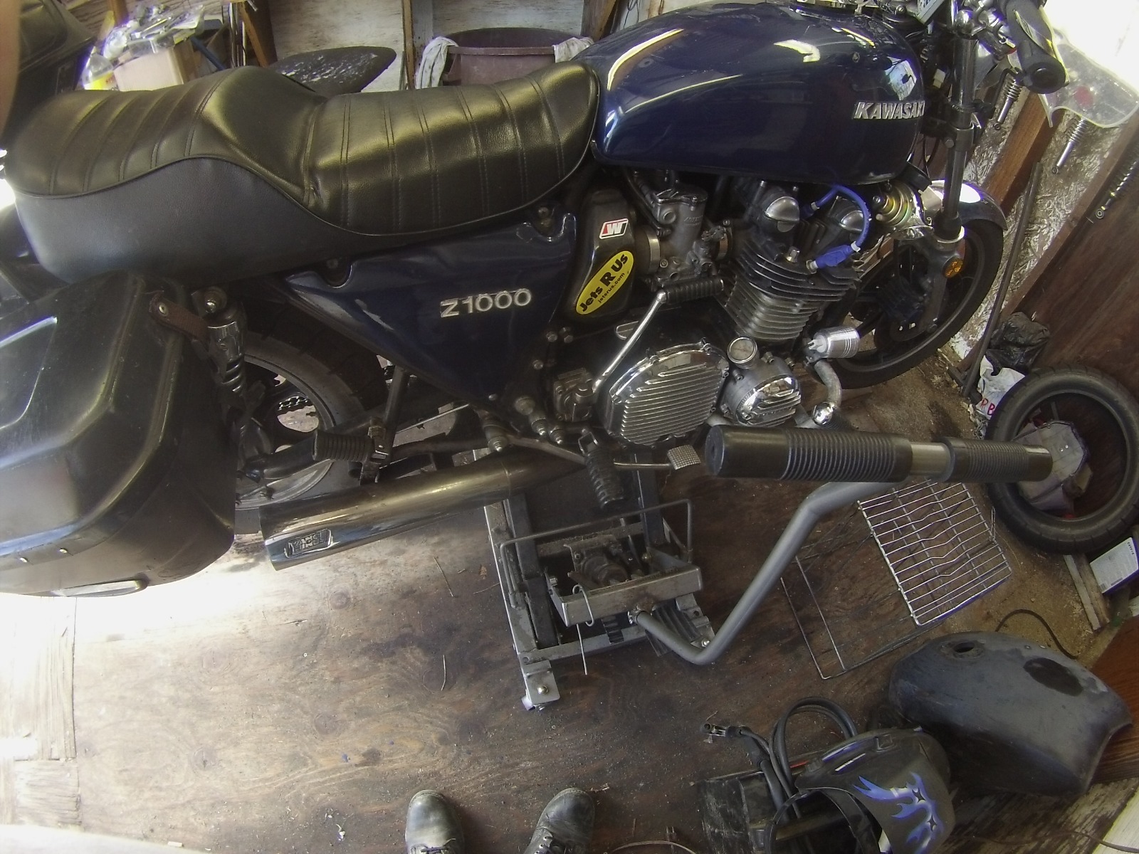

And finally: pictures! We might, on average, be pretty old here at KZR, but we have shortened attention spans and we need some eye candy! Let's see this machine.

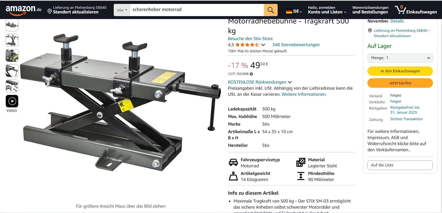

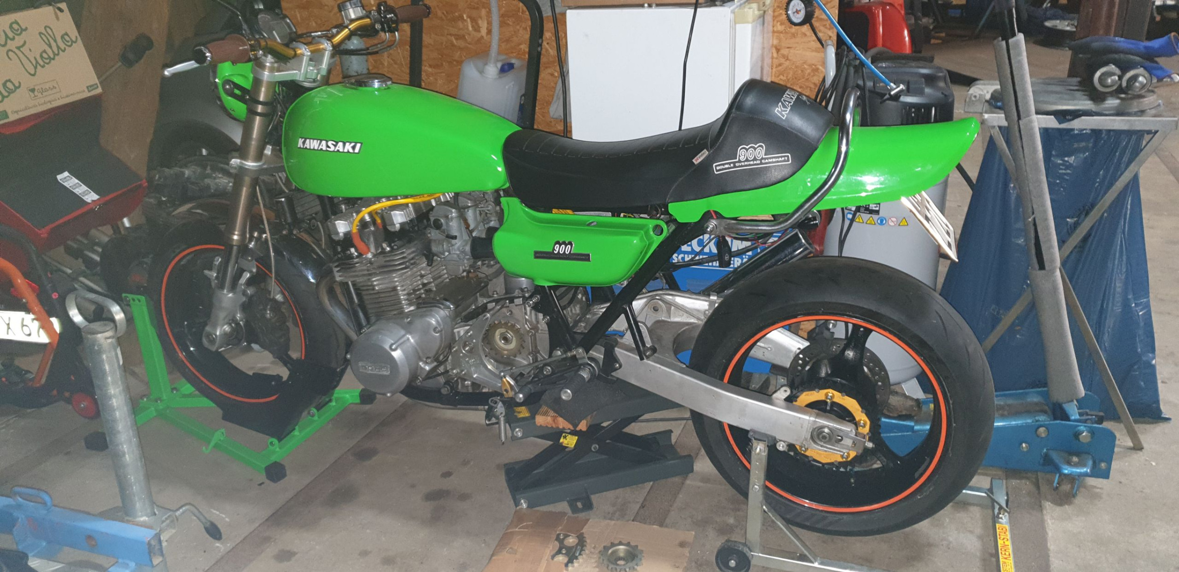

Amazon offers bike lifts with a set of adjustable adapter for the lower bike frame tubes.
Definitely a better option than wood blocks but probably still wouldn't give the access to remove the oil pan ? (maybe) OP is looking to replace the oil pump

Center stand is the best for your use. Don't use the pipes to support the bike. I bought a HF lift and made my own adapters to support the frame.

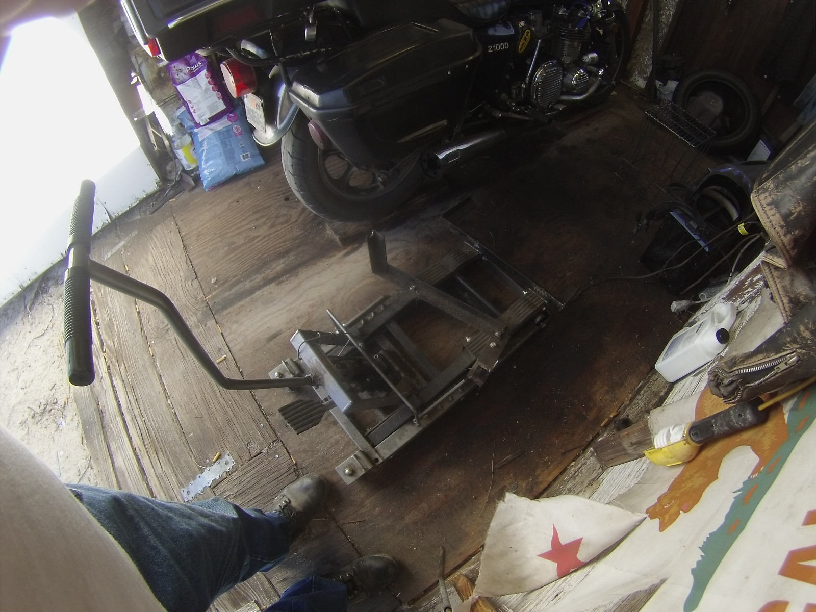

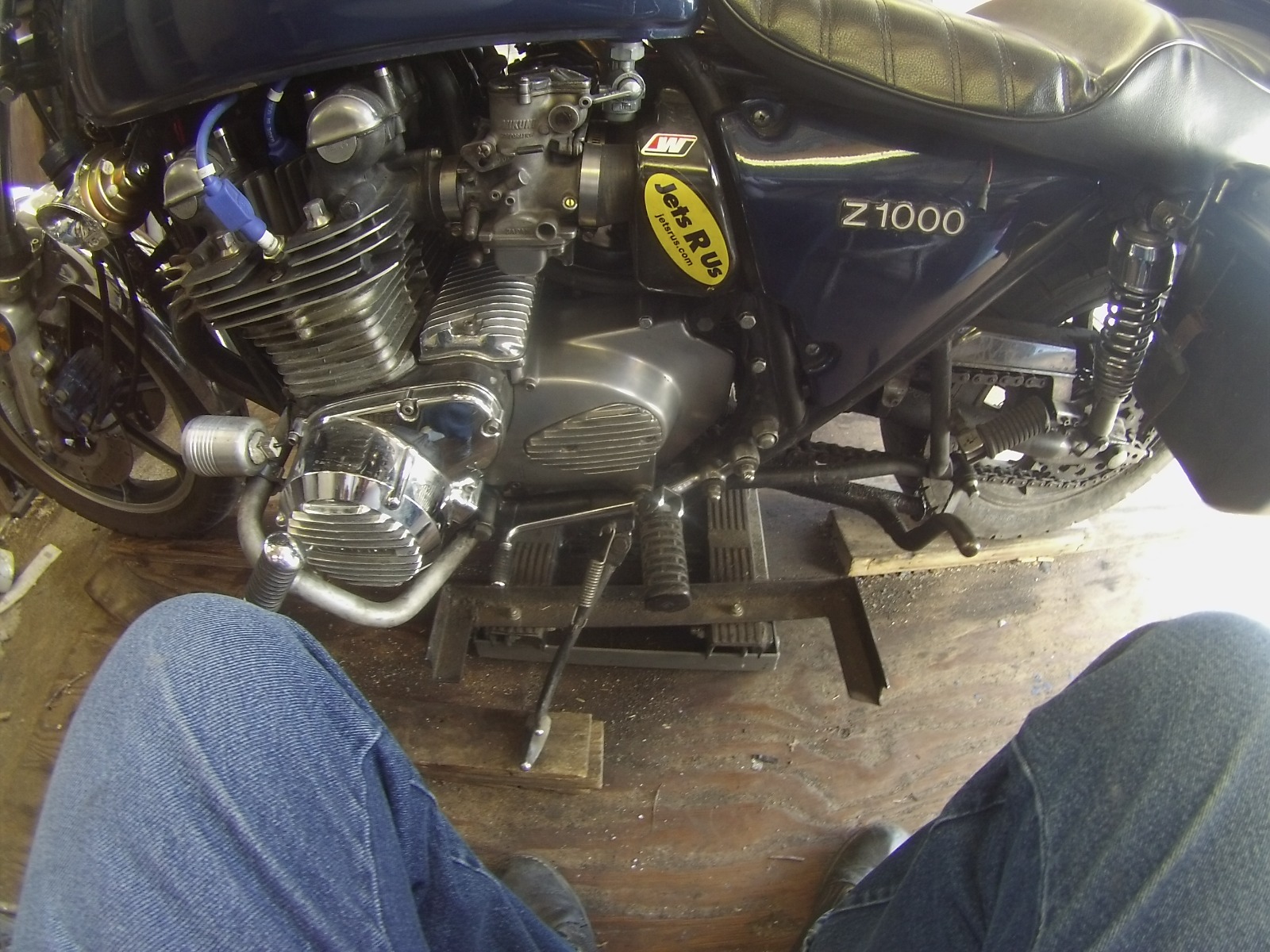

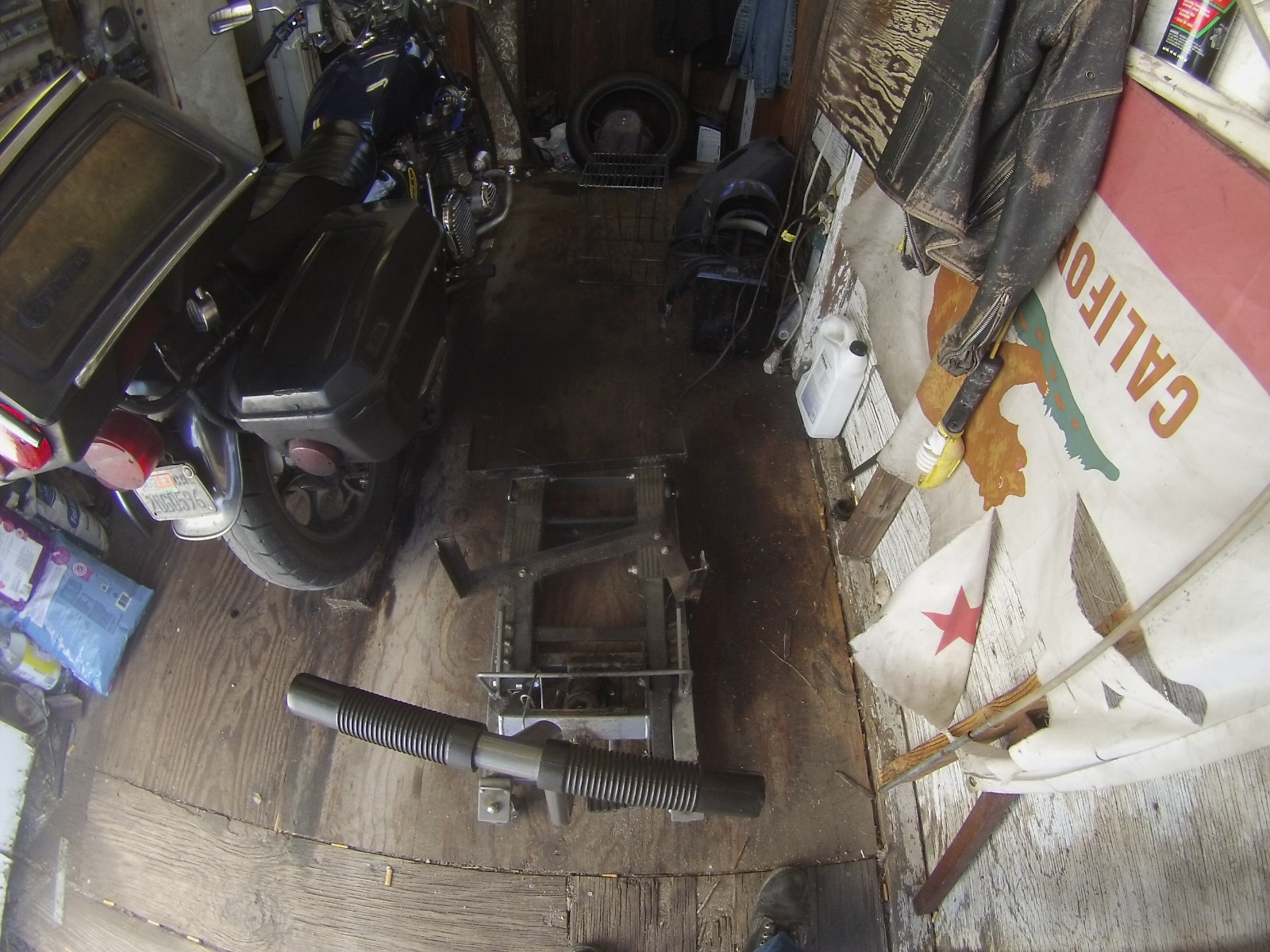

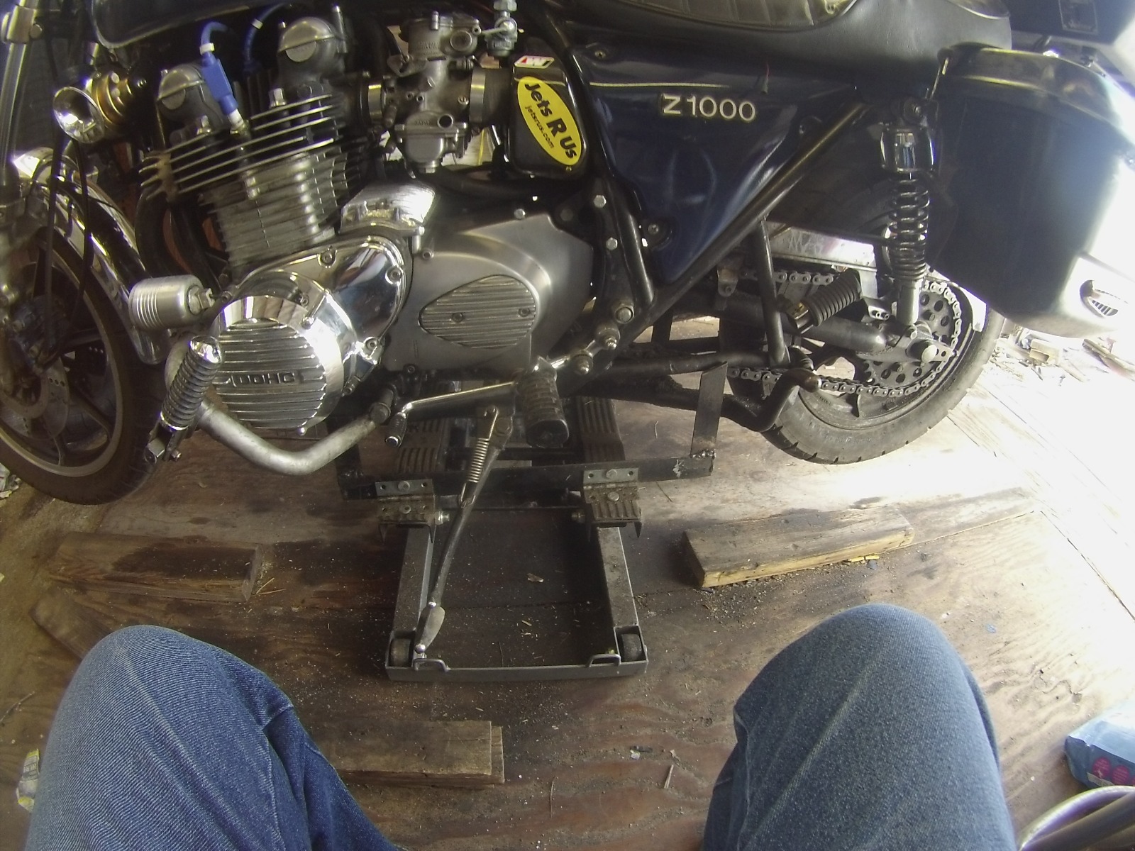

You can put the bike lift under the main stand frame mount to remove the oil pan.
The rear lift in the pic only support the swing arm high (no shock) to secure the wheel in/out for the wheel aligment messurments.
The front wheel stand keep the bike in a safe riding position without any additional jacks.
