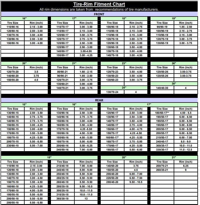

Stock size on the SR is
5.10-16 ...
What I'd like to do is run Bridgestone BT46s on the SR ... but what modern size corresponds to 5.10?
Is that a 130/16?
There used to be a chart!
Here is what Bridgestone offers:
www.bridgestonemotorcycletires.com/en-us...igin=product-results
Suggestions welcome
Is that a 130/16?
Suggestions welcome

I would run the 130. Tried and true.
