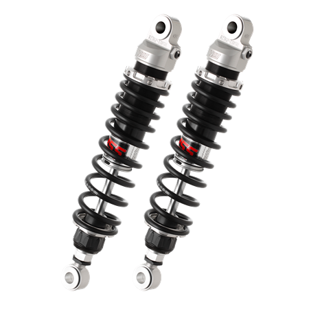

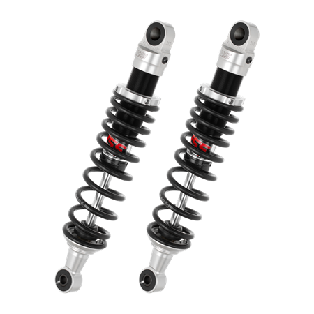

YSS shocks
www.suspension-store.com/YSS_Kawasaki_Z_440_80-84_KZ440A
www.yss.co.th/products/list?vehicleTypes...odel=18926&year=1984
YSS-RE302-330T-25-88
YSS-RZ362-330TRL-25-88
