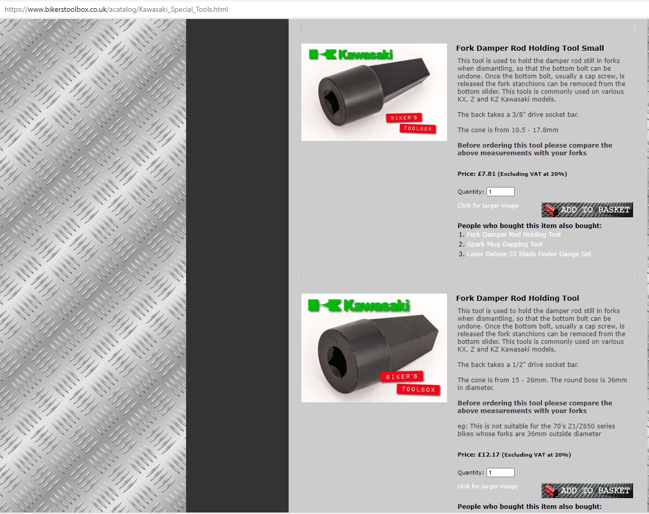

All the tools I have seen are tapered square not hex ?? there seems to be two different sizes
The following user(s) said Thank You: scubaanders

I have the 3/8th smaller one. Did the Zeph11, ST and the GPz11 A1 with it.

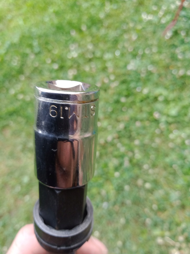

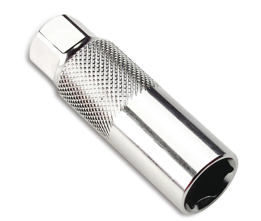

Commonly, the hex on the bottom of a spark plug socket will work.  Put a long extension into the open end of the socket, with the hex facing down.
The following user(s) said Thank You: sf4t7, scubaanders, Wookie58

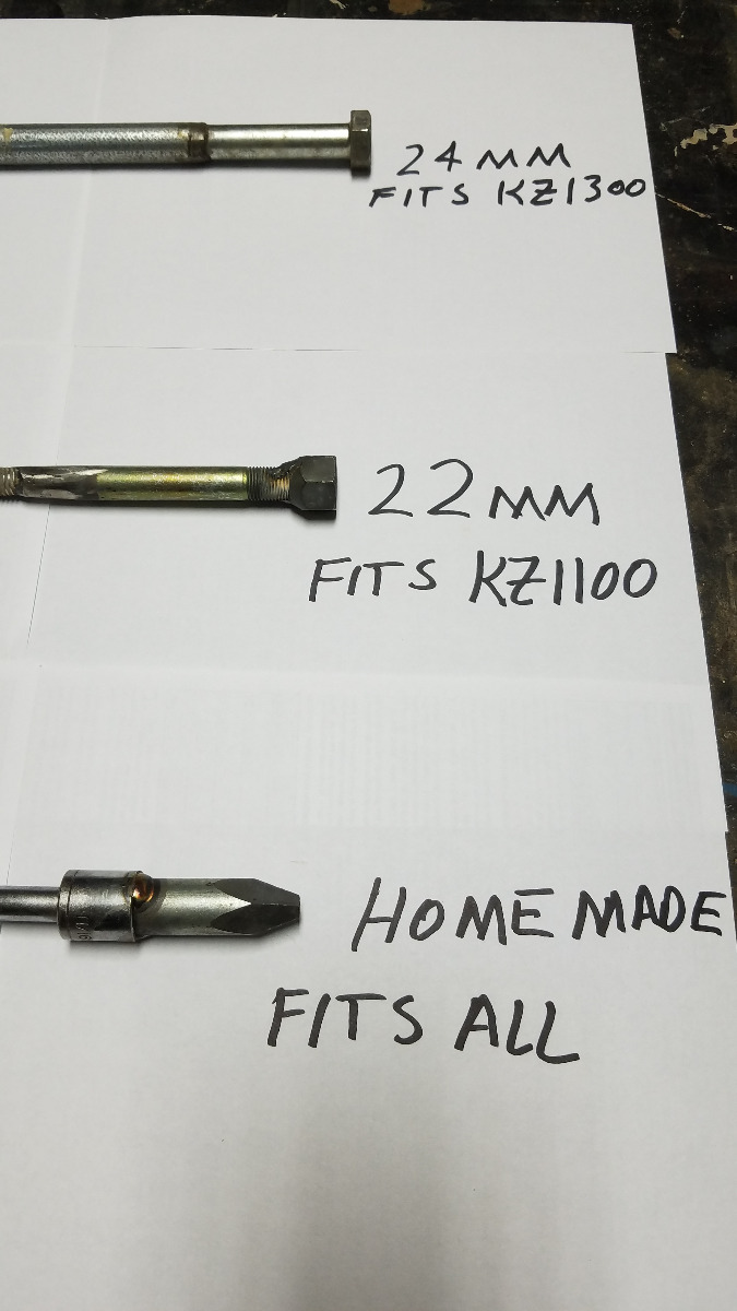

Hello Scubaanders,
I've had problems with removing damper rods as I'm sure most of you have. Not done correctly the fork slider can be damaged. I always try to see if a hex will do the job before I break out the tapered universal tool. I have had success with a 22mm hex on my KZ1100 Shaft and with a 24 mm hex on my KZ1300.
Regards
