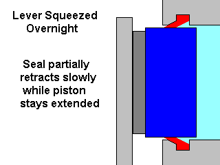

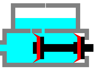

Check the tiny relief port in the MC is not clogged.
Animation made by R.I.P loudhvx, AFIAK
MC normal movment
MC bleeding movement
Last edit: 19 Jun 2024 15:00 by Scirocco.

Yes its my oem brake system!! Dont looks like new bike with Bolt to master cylinder!! Some clamp to the oil bottle and master cylinder!! Thank you for the picture. I will disassemble the master.. cannot find some pieces for rebuilt rear master cylinder

I agree with scirocco, I had a KH400 with same issue on the front (crack the nipple and good to go again) the return port in the master was blocked with crud.

I'm another agree. Just had this on my ST on the front. After changing the top hose it wouldn't bleed and very small bubbles came out the feed hole. My suspicions were raised when it was impossible to back bleed.  Once the hole was cleaned out it was bled in 5 minutes. I had initially put it down to a collapsing brake line or old fluid.
