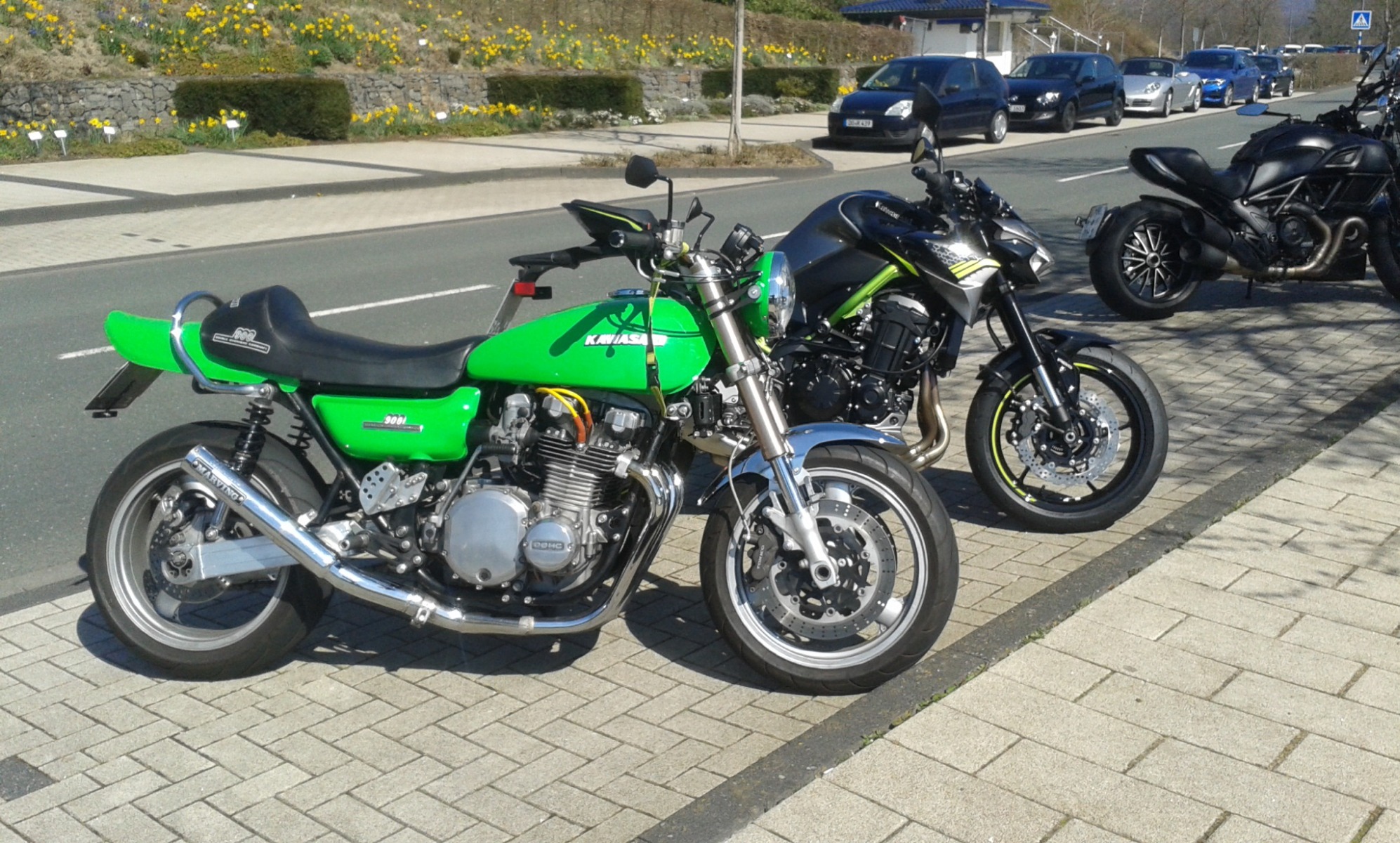

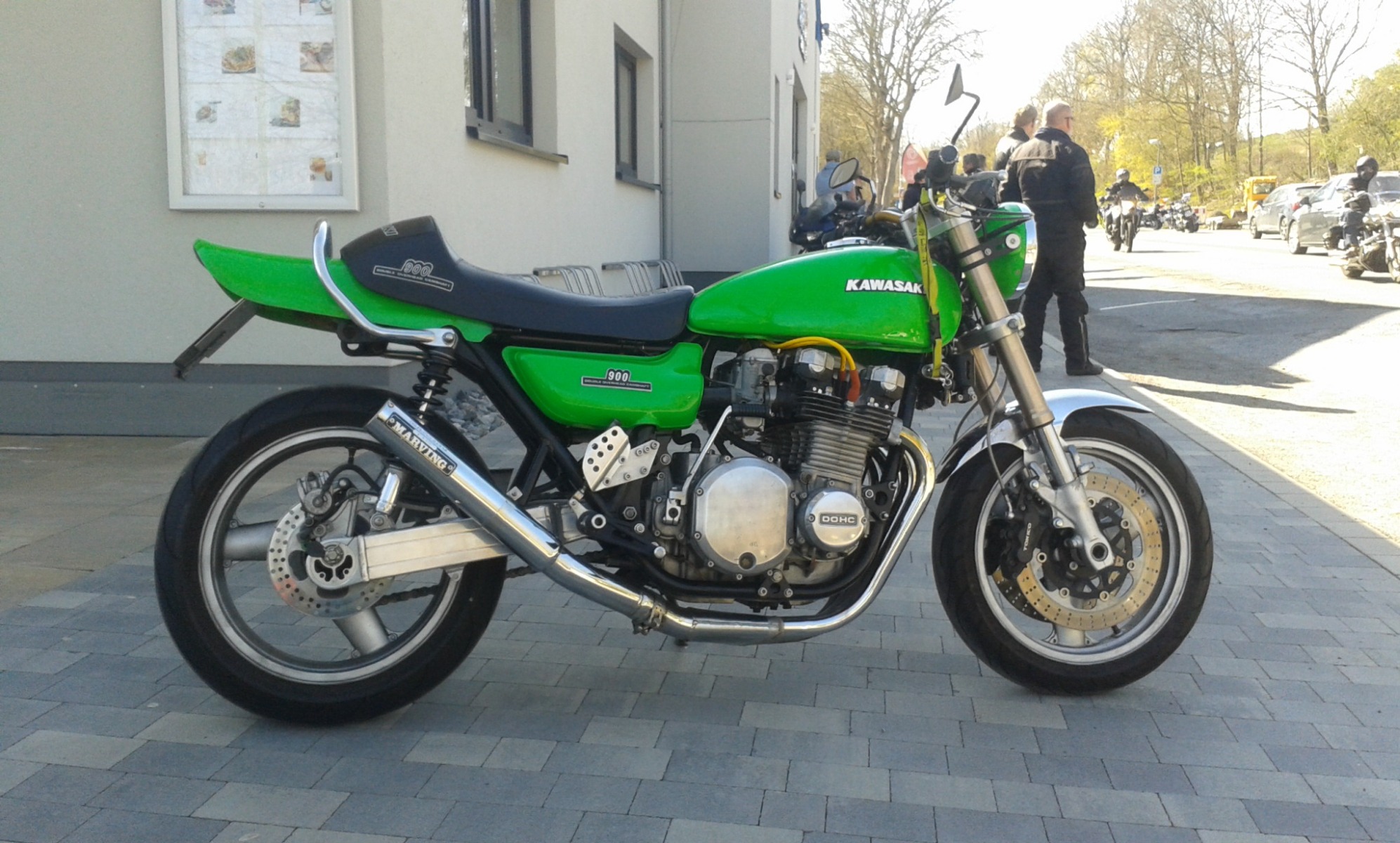

The 1994-96 ZX9R B model fork with Tokico 6 piston caliper would be the best choise becaue of the optimal fork length for the ground clearence..
