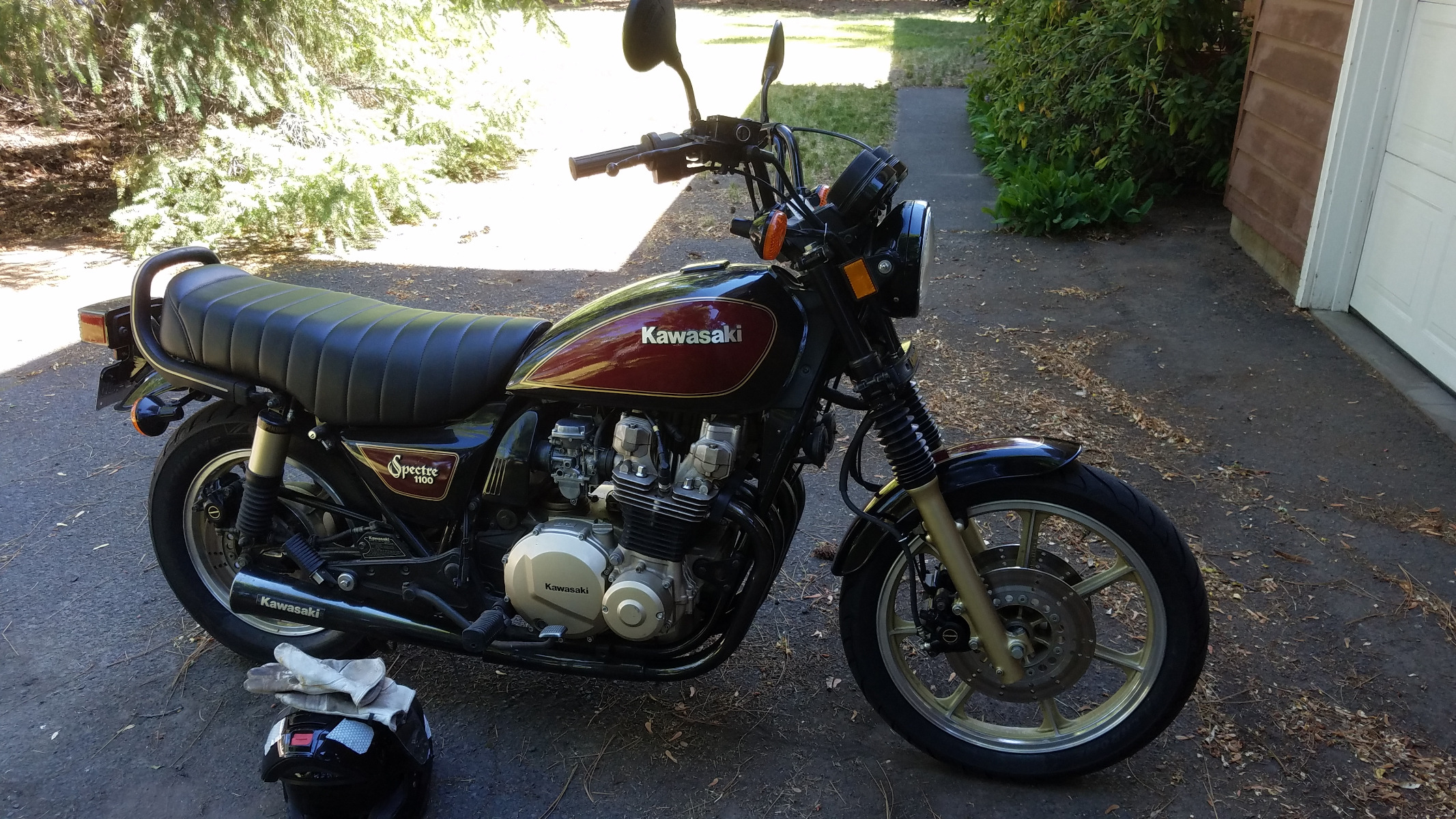

I actually got the Spectre done, except for the bars. The forks came apart easily enough. I elected to replace those internal O rings for the balance tube. Pushing the fork legs through the new O rings took a lot of twisting and force.
On the expense side, all I had to do was apply $1,000.00.
New tires
Fork seals
Front brake pads
Modified seat
I'm pleased with the result so far and plan to use it as a daily rider instead of my 1300 this year. I haven't weighed it but this is one heavy bike.
Bill

12 Jul 2024 14:24 - 12 Jul 2024 14:31I found a set of bars on an old kz900 I have just to hang parts on. I swapped them for the buckhorn bars on the Spectre. Oh what a difference. This bike's a rider now.I actually got the Spectre done, except for the bars. The forks came apart easily enough. I elected to replace those internal O rings for the balance tube. Pushing the fork legs through the new O rings took a lot of twisting and force.
New tires
Fork seals
Front brake pads
Modified seat
Bill
A friend who does 10 track days a year told me about a phenom or issue that track racers have to deal with and i think it describes quite well why I found the original bars so uncomfortable.
He says that while really hanging off on right hand turns you have to raise your right elbow so high that it's difficult to control the throttle. Racers call it screwdriver throttle. I know what it feels like and I don't like it. Any way a set of bars from an older KZ made the difference.
Realizing that this thread is going off topic, I'll ask for a bit of grace while I tell you about the tires I chose.
I went with Avon Cobra Chromes and it was a good choice. Not only do they have good grip and are described to have good wet grip but their turn in is very quick and smooth. These tires like to turn. I've got 'em on my Valk and my Roadliner also.
Bill
