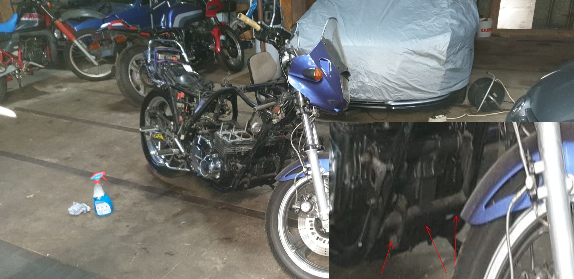

Ok, I may be jumping the gun on my build. I purchased a 1981 J model 1000 for my 1978 KZ 1000 frame, it doesn't look like it will work to me. Any thoughts or advice?

Why do you think it won't work ?

Being a novice at bike building...after some more thought and measures it looks like it will be okay. Does PDM on here still do business? I tried contacting but haven't gotten a response yet.
