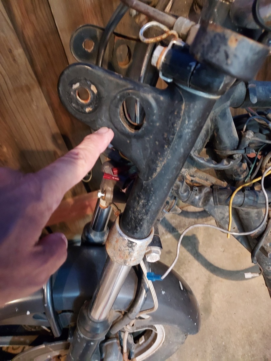

I keep finding picuters like that but its tough to see if it really is with the headlamp bracket or not. I have what I believe to be the original headlamp bracket and assembly and I dont have any mounting points for the turn signals on it.

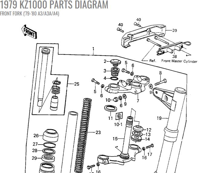

See #19 on the attached parts diagram. The turn signal stalk passes through the headlamp ear, BEHIND the bolt that holds the bucket into place. That is evident by the diamond shape cut out on the part depicted in the diagram. That cut out is for the rubber mounting grommet for the turn signal.

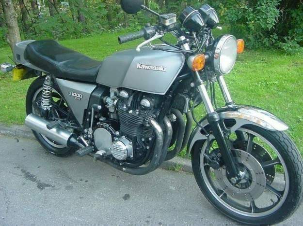

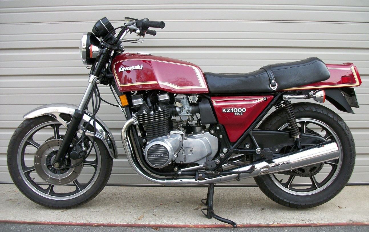

Bob that is really interesting, the red bike I posted appears to be as you show but the grey one is through the headlamp mounts and the OP says there is no facility in the ears he has ?????? Maybe different model years or markets ?

12 May 2024 19:42The one I pictured is a stock 1979 MKII. The grey one you posted appears to have Z1R side panels(?) But with a MKII style tank and tail section. Or is it an ST? (which uses same style as the MKII I wasn't able to tell. I do know that the fork-headlamp ears are interchangeable amongst several KZs with 36mm fork tubes which leads to many "Bitsa-bikes" Put together with a bit of this model and a bit of that model..Bob that is really interesting, the red bike I posted appears to be as you show but the grey one is through the headlamp mounts and the OP says there is no facility in the ears he has ?????? Maybe different model years or markets ?
